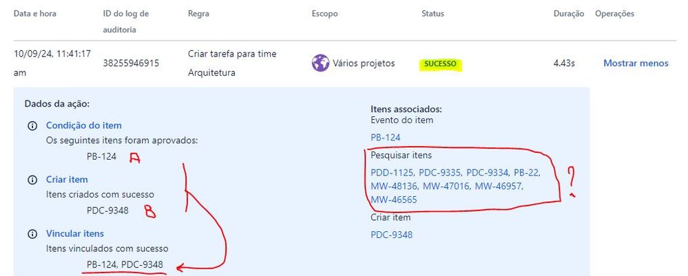

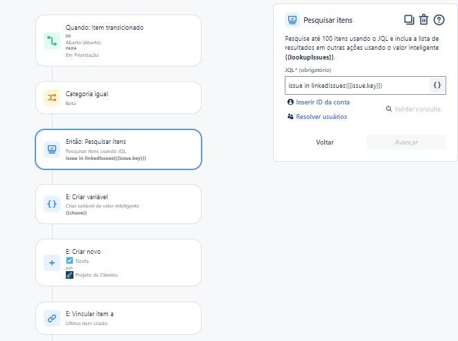

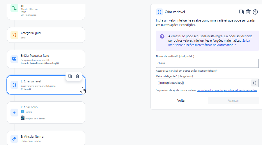

This is the automation I'm trying to do and it's not working 100% ok.
As I said before, when card A is transacted from status, card B is being created in another project and both are linked.
Now I need to take the linked issues from card A to card B and that's not working.
The message I get is that no items were found in the search.
Thank you.

Trudy P Claspill
September 11, 2024
Hello @Andre de Castro

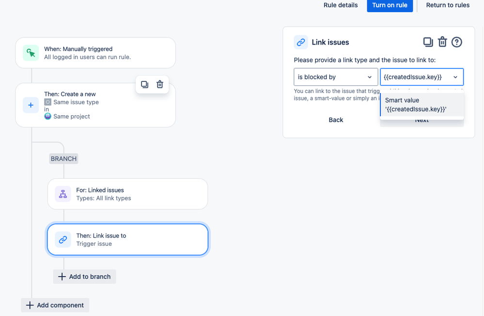

I recommend you use make these changes:
Delete the Lookup Issues action and the Create Variable action.
Within the Create Issue action select the Linked Issues field to set. Use that to create the link between the newly created issue and the trigger issue.
Delete the Link Issue action after the Create Issue action.
At that point add a Branch - For: Related Issues: Linked Issues. In this position the branch will iterate through all the issues linked to the trigger issue.
Within that branch add a Link Issue action. You can use a smart value to get the issue key for the issue you created in the rule, to link each of the trigger issue's linked issues to the issue that you created in the rule.
https://support.atlassian.com/cloud-automation/docs/jira-smart-values-issues/#--createdIssue--
Here is an example:

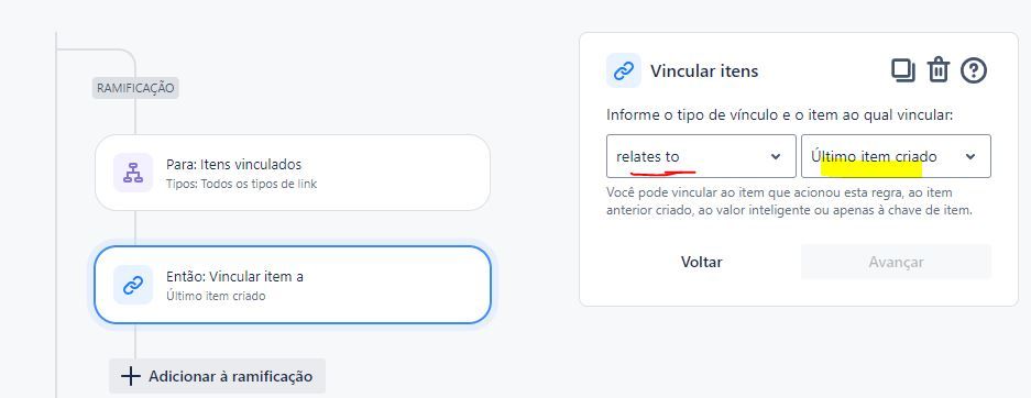

Andre de Castro
September 17, 2024
Hi Trudy.
After your guidance, the automation worked correctly. Thank you.
However, I didn't understand the use of smart value so I linked the issues (in the trigger issue) to the new issue created.
Just one more question...
Is it possible to make the linked issues in the newly created issue have the same type of link that they had in the trigger issue?
At the moment, they all have the same type.

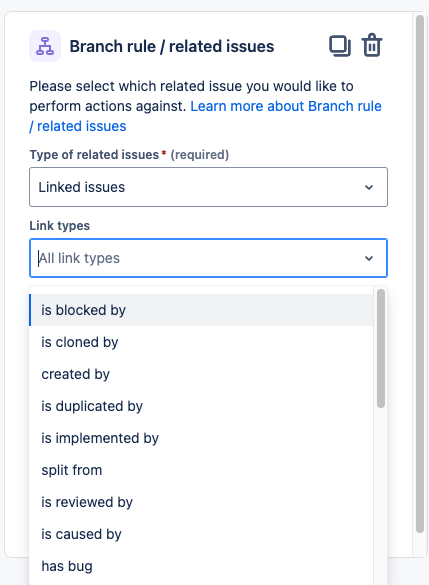

Trudy P Claspill
September 17, 2024
Hello Andre,
The first solution that comes to mind is to use multiple Branches with each one selecting a specific link type.
In each Branch in the Link Issue action you would choose the matching link type.
