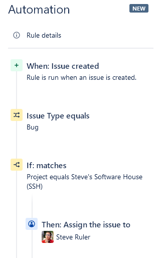

for this to work you would need to put the "project" (as far as I understood it is a custom field) into an automation rule, like this:
For this example I just selected the user name in the automation. You referred to the "project lead" - is there a need to get this programmatically? Assuming it won't change that often I'd try to start with the rule as shown above for a test drive.
The above shows for project Jira's own "project" selector. Please replace this with a custom field "project" that you said having in place using type drop down - it works the same.

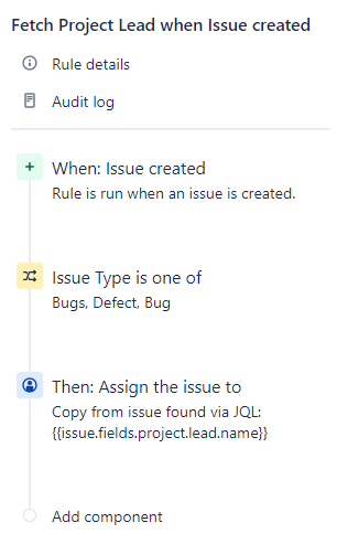

I am stuck on how I can retrieve the project lead from that drop down custom field. Here is what I currently have (and does not work)
The try to retrieve the project lead from the drop down field is having exactly the problem - the 'null' value for Project Lead. The workaround was therefore to hard code the values until this will (maybe?) fixed some day. I am not sure if there are any other workarounds - but let's see what other Automation experts might come up with =)

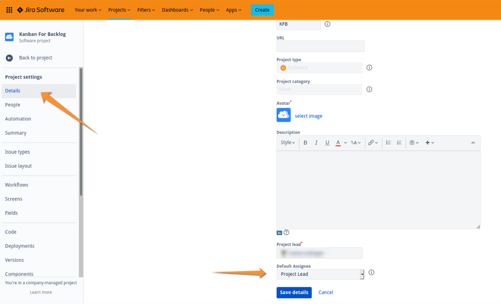

Hi @Christophe Gonne If this is for all issues in the project then on projects details section you can update the default assignee to project lead as shown in the below screenshot.
Or let me know if you looking for certain issues-type only.
Thanks Sagar,
Yes I know the field location, let me clarify my request.
I have a bug board where users are logging defects, in the ticket creation process I am asking them to identify the project to which the bug they are reporting is attached to. Then after the ticket is created I would like to get the "Project Lead" of this project and assign the bug to that person.
