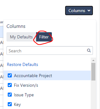

Having tried and failed this several times I started doubting if this 6 years later, indeed still was working as it was answered her. But the (currently ) essential part is not included.
1: Create and Save your Filter.
2: When you view that filter click "Columns"
3: In the top of that dialog you can choose between "My Defaults" or "Filter"
When you want JIRA to remember a specific set of columns for the loaded filter, you have to choose "Filter" and configure it. Doing that, you are working with a custom column setup for that particular filter, and not just adjusting you default column settings across all other filters.
This is incredibly useful in my opinion.

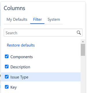

For the sake of completeness, I can add that I originally testes this on "Jira Software V8.x" and just now to be completely sure, I verified it on another instance in Atlassian Cloud, where it also is working as described.
In the Cloud version I noticed there is an additional "System" option, that I had not noticed before. A system wide column setup, same for all users.
Cloud version
What version are you using? Not sure if this could have anything to do with this?
Thanks, Anders. I'm in the Cloud version and was able to get it to work after playing around with it a bit. There was some weirdness around saving the filter and Jira acting as though I was trying to change a filter I didn't own (even though I was the one who created it). Thanks for verifying it it the latest versions.
