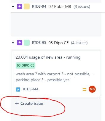

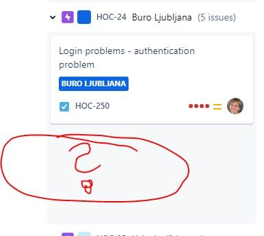

in some projects we have + Create issue at the end of an epic. In others this option is missing and we can't figure out why.
All projects are company managed.
Ho do I add this option to the projects, where it is missing?

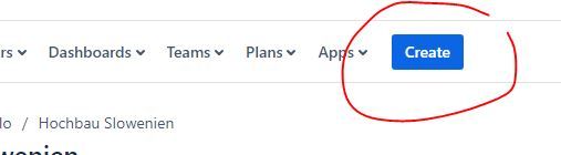

Hello, we can all create issues but only if we use the Create Button on top. This is true for both projects.

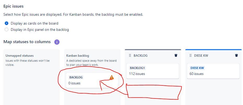

We found the solution, we just don't know why it worked.
We had to move "Backlog" to Kanban backlog like displayed in the image. We have no idea why that worked.
