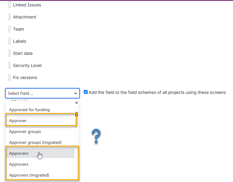

I am currently struggling setting up space screens with the right fields as in Cloud it only shows the Name when searching for field to add. Which is not helpful when managing spaces for multiple areas who use similar naming conventions but different field types.

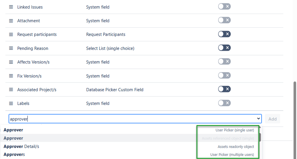

In Data Centre I was unlikely to get this issue as the field type is visible when selecting the Field name from the list.

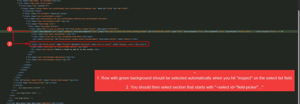

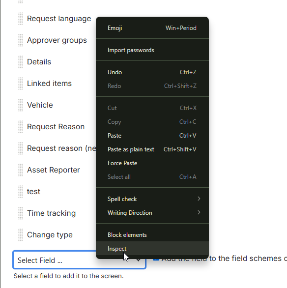

1. Open the screen you want to edit
2. navigate to the field select list --> right click on the input box --> inspect
3. Developer console will open, go to elements tab and check that the following row is selected:
<input autocomplete="off" role="combobox" aria-autocomplete="list" class="text aui-ss-field ajs-dirty-warning-exempt" id="field-picker-field" type="text" aria-haspopup="true" aria-expanded="false" placeholder="Select Field ..." aria-invalid="false">

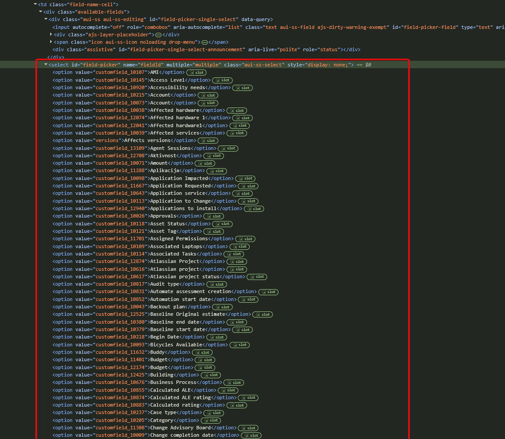

4. few rows below that one is this one:
<select id="field-picker" name="fieldId" multiple="multiple" class="aui-ss-select" style="display: none;">
  • When you expand that section, you'll be presented with the list of fields available in that select field picker.
  • This list contains both name and field ID, so it's easy to see the order and select the right field based on field id.
See the images below:
