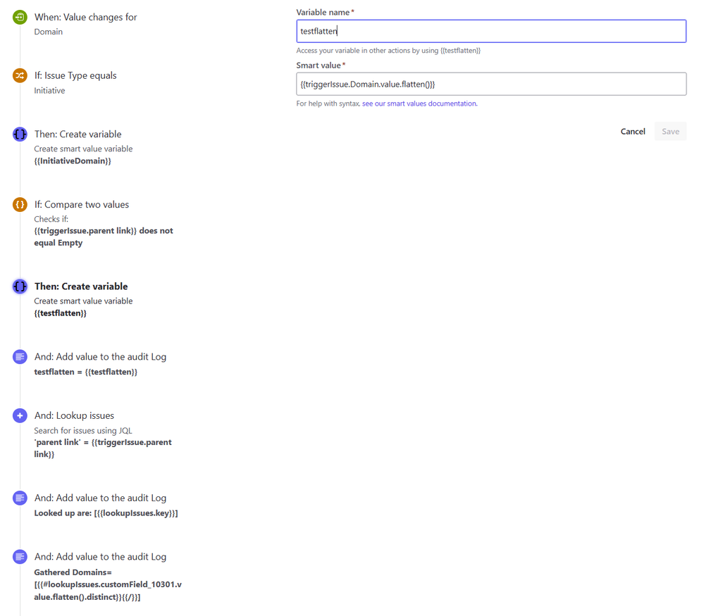

0: The trigger of the automation would be a change in the Domain value of an Initiative
  • When: Value changes for Domain
Followed immediately by the check if it's an Initiative that we're dealing with:
  • If: Issue Type equals Initiative
And checking if the Initiative indeed has a parent Movement
  • If: Compare two values: Check if: {{triggerIssue.parent link}} does not equal Empty
1: As per @Bill Sheboy's solution in the link above, I first lookup the issues:
  • lookupIssues JQL: 'parent link' = {{triggerIssue.parent link}}

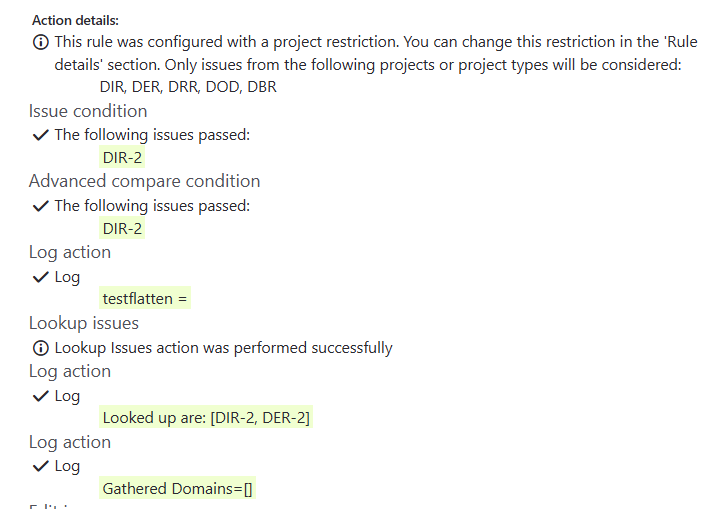

And I verify the lookup by logging it (the correct issues are looked up) using
  • Add value to the audit log:
    Looked Up are: [{{lookupIssues.key}}].
This indeed gives me the initiatives that are children of the parent Movement of the trigger Initiative (the square brackets are there to more easily see an empty result).

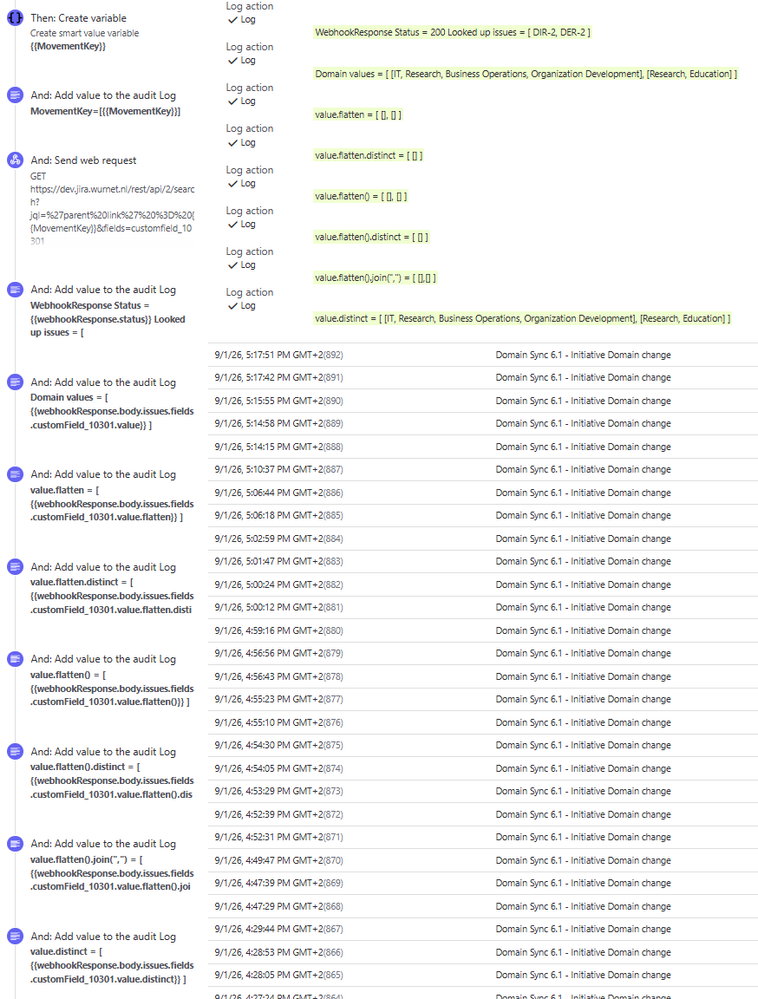

I've been dabbling with creating variables inside the automation and writing their content to the audit log, to find out what is going on. It seems that as soon I'm using either flatten or distinct, I end up with an empty Domain value.
