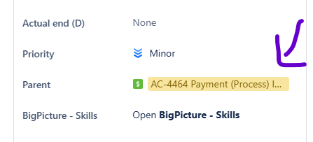

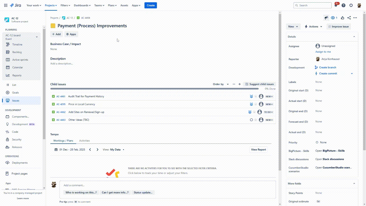

I am using different issue types like Initiative. However, when I change the color, it just flips back to and doesn't retain the settings. I want to color code my roadmap, and this issue is driving me mad. Are there other ways to change the color, or is there a setting I'm missing?

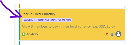

For a couple I have managed to change the color somehow.
Like this one is yellow
When I look at the child issues, the parent is correct (in yellow)
But on my kanban board it shows in purple which seems to be the default.
What am I missing?
I am trying to create hierarchies with the color coding, so my entire plan is out of the window where few just don't change.
(PS: this is a problem I am facing since weeks, so I have tried to turn it off and on again ...)

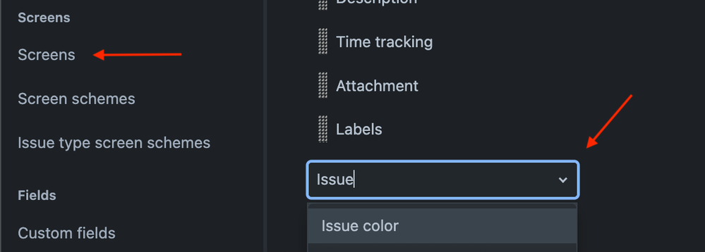

I had the same issue as described in this topic. However, after adding the "Issue Color"-field to the screen of the initiative, it was solved. As a Jira-admin you can add this field from Settings => Issues => Screens =>> here pick the relevant screen linked to your initiatives. Hope this works for you too!
Worth mentioning: after adding the Issue color field to the screen, the "Issue Color" field itself was not displayed in the tickets; even though it's also in the list of fields within the layout. However, in my case this was enough though to "unlock" the ability to change the color.

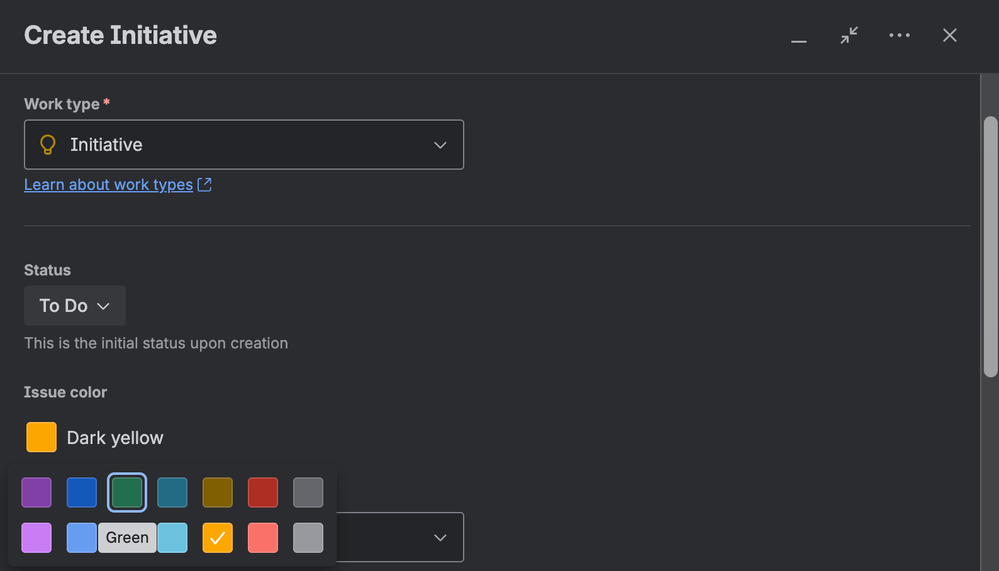

Michael_ Janine
June 17, 2026
"Same" problem.
Our support added the "issue color" field to the "initiative screen". It shows up when creating a new issue - ok, fine. But afterwards the field is missing in the ticket details although I can see the field in the configuration. So I cannot change the color of iniatives.
My mistake or is this feature (changing the color of initiatives) missing?

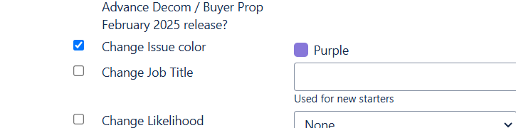

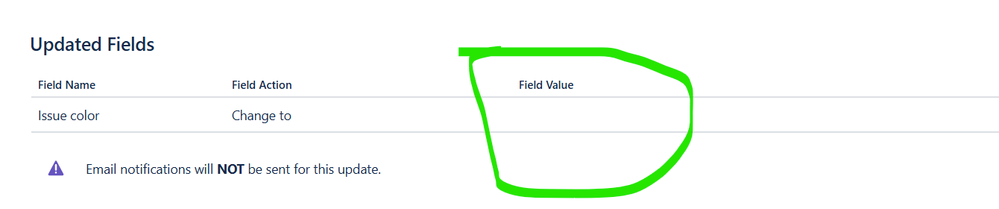

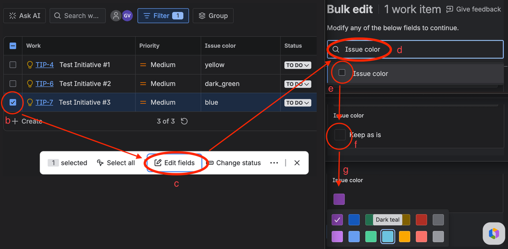

Think I found a (somewhat weird) workaround.
Allegedly Issue color can be bulk changed. However the field is non editable in the bulk change screen - this seems to be a known issue.
When I select the option it seems to clear out / reset that field.
After that my color was purple but at least it let me change it now.
Maybe this helps someone else regaining their sanity :)
It didn't change the color on the kanban board. Appreciate any hints how that could be achieved. Will hide it for now.
