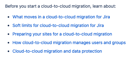

Have you reviewed the additional documents that are linked in the one you found?
I have not actually done a Cloud to Cloud migration myself, but I've have been advised in the past 6-12 months that the process is less full-featured than the self-hosted to cloud migration.
I advise you to look closely at what does and doesn't migrate, and do as much testing of the migrations as you can. Since you are on the Premium subscription you'll have access to create a Sandbox from your production environment, to which you can copy your production data. Unfortunately third party app data does not copy to the sandbox, but such an environment would at least start giving you an idea about the impact of migrating into an existing cloud environment that already has data and configurations.
