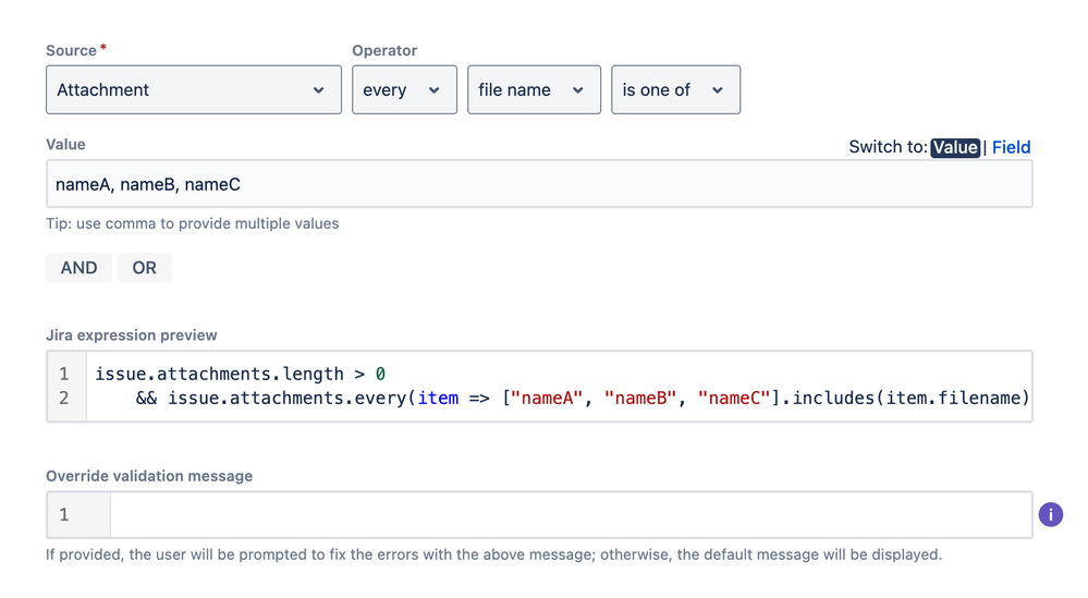

  2. Use 3rd party validators, which are based on Jira-Expressions
I’m from Forgappify and we’ve been working on a more flexible way to build conditions using Jira Expressions. This led to the Ultimate Validator (now in Beta), which is part of the Workflow Building Blocks for Jira app. It lets you use most of the power of Jira Expressions—but without writing code. Instead, you build conditions through a simple UI Here’s an example how you can check file names of the attachments:Attachments_must_be_one_of_3_names.png

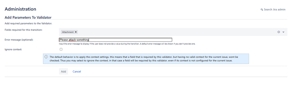

Hi @Suzanne Cranfield , thanks for your question.

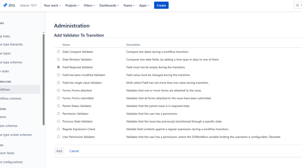

You should be able to use a validator to prevent the transition if there is no attachment.
The validator I would use is this one -
It doesn't explicitly say you are checking for attachments but you will note in the field attachment is available in the options -
Here, you can also specify a message for when someone tries to execute this transition without an attachment.

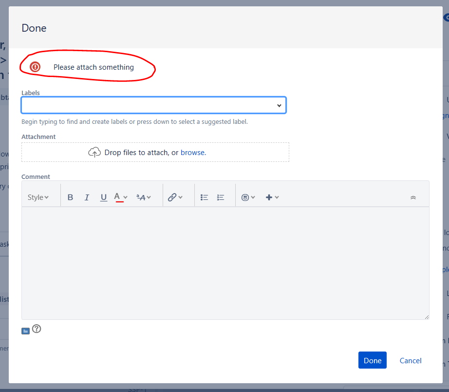

You could also create a specific screen for this transition so that you generate a pop-up which shows more clearly what you need to do in order to complete the transition, but this solution should also work as you anyway get the feedback that the attachment is missing.

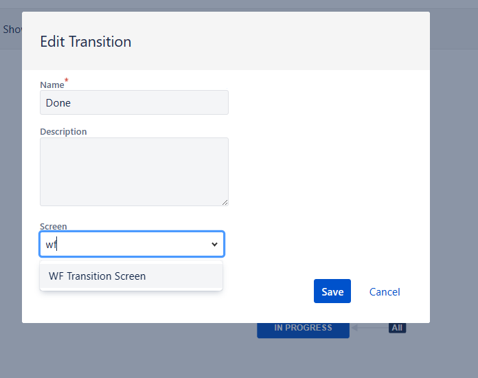

For the screen solution, you can just create a screen with the fields on it you want people to fill in before allowing them to do the transition and then here, click on Edit
and choose the screen you just made -

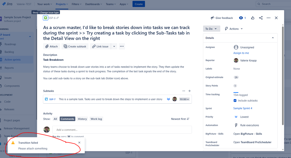

When I go back to the issue and try the transition, and then in the screen, I don't attach something, you can see it is more clear what I need to do to pass this -
