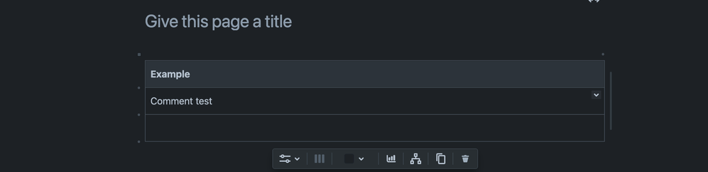

There is an option in confluence to add the inline comments. Let me explain:
  1. On the table that you are using, make sure that you are in the edit mode

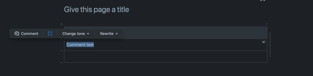

  2. You need to highlight the text within the row and then select the Comment option

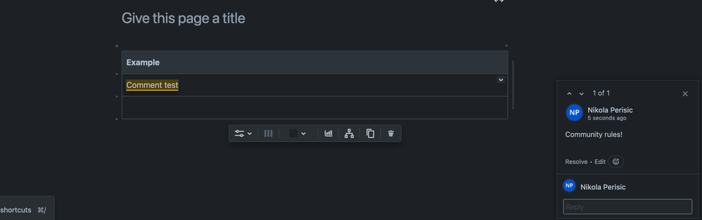

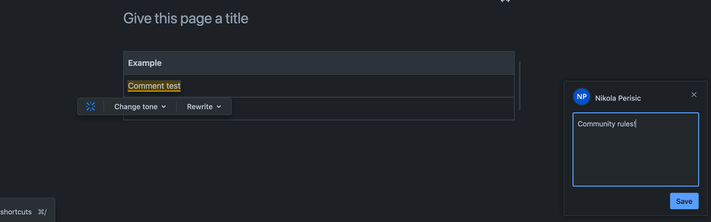

  3. As an outcome, you will see the comment shown on the right side of the screen
  1.                    Picture of an example table that I have created
   2.                        Highlighting the text where the Comment option is being shown
  3.                     The right side appears where the comment is being made
4.                 As the outcome, comment will be shown. Every highlighted text will be link to the comment that was being made, and you will be able to directly reference the comment from the highlighted text.

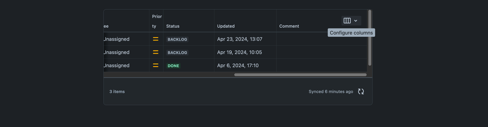

Nikola Perisic
April 23, 2024
You can use the Jira issues macro, when you type / and then choose the Jira issues. There are two versions: Newer one and the legacy one that is based on the JQL queries.
When you do this you would need to select your project, filter between the issue types that you have mentioned, and when this is done, you will get the generated table which CANNOT be edited, except adding the columns.
To see the Comment column, you need to click on Configure columns:
Make sure your issues indeed have the comments within them. Sync the macro and try to see if it works.
