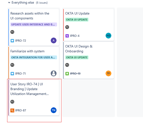

I am using QAlity Test Issue type for QA testing. This ticket is linked as a "test" to the story. How can I have the QA ticket drop down with the subtasks for the story in the scrum board? Would like the issue to appear here under the storyIt appears under everything else

I have tried to reproduce your Scrum board configuration and it seems like your screenshot shows that the board is grouped by a Subtask, meaning that all issues shown under your story are subtasks.
Because of that, with such a configuration, only subtasks can be placed under the tasks, stories etc. and as QAlity Test Cases are a separate issue type from a subtask, they unfortunately cannot be assigned as a child issue and viewed in a manner you requested.

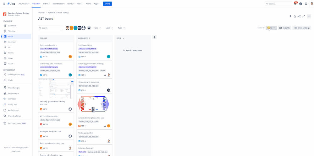

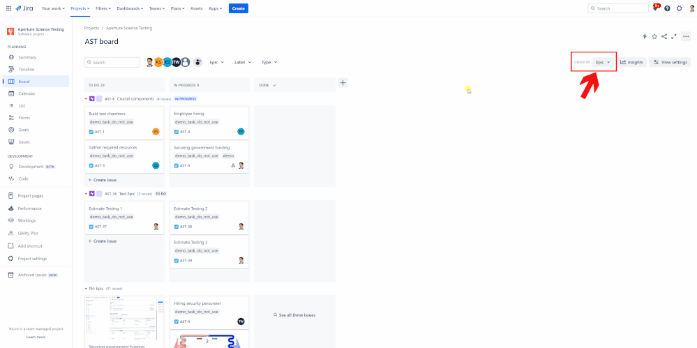

However, as a workaround, you can switch the grouping to Epic, as you can add any type of issue (including QAlity Test Cases) as a child issue and view them in a drop down menu under the epic:
