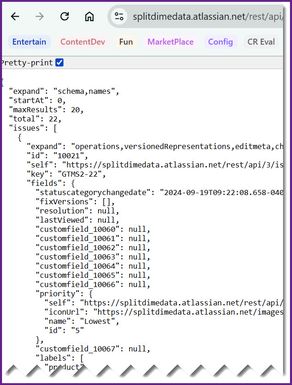

As a GET call, you can troubleshoot in your browser.   I just ran this call against my instance and it worked as expected:
https://splitdimedata.atlassian.net/rest/api/3/search?jql=Project=GTMS2&maxResults=20&startAt=0
Have you used your REST call before?  I can get close to your response (ID only) if I add the "&fields=id" to my API Call.
You may want to make sure your JQL string isn't causing an issue.... (Here's a hint - use a filter whenever possible  jql=filter=88888).  You can also experience strange behavior if you are not logged in or authenticated correctly.   Is you call embedded in code somewhere?
Run your GET call in the browser and trouble shoot from there.
