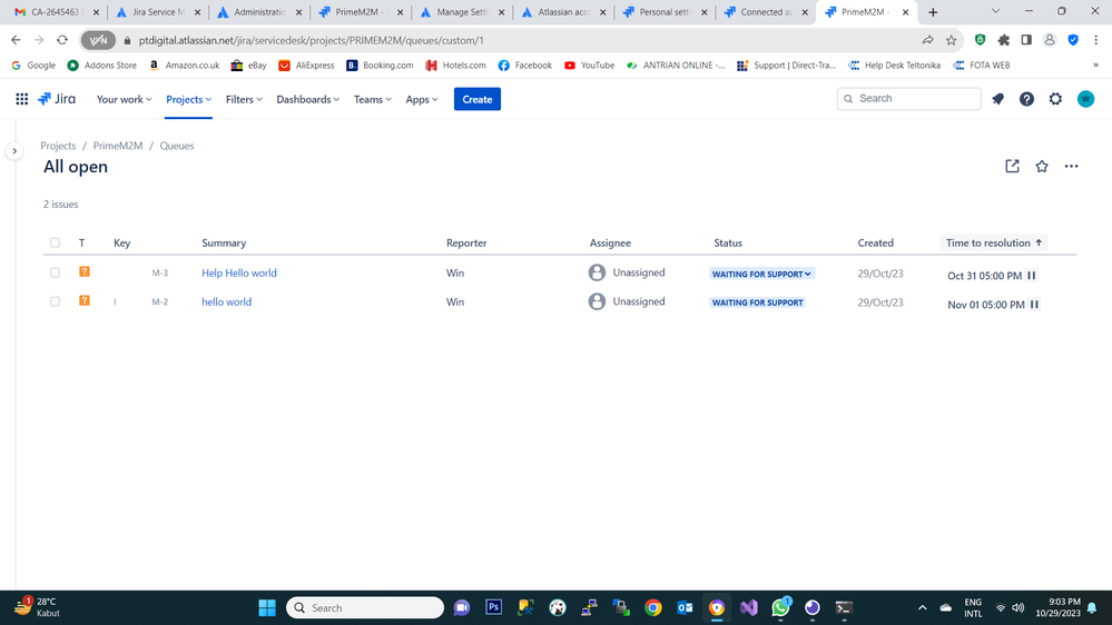

I have 2 tickets, ends with -2 and -3 (see the screenshot), my question is why the latest ticket (-3) having the earlier time to resolution?
Hi @Win
The [time to resolution] and the [ticket created time] are two different concepts. As for SLA [time to resolution], please go to JSM project setting to check the logic, which my be depended on some other fields (e.g. priority).
I think you will get it after you check it yourself or ask the project admin to assist you. Good luck.
Thanks,
YY哥

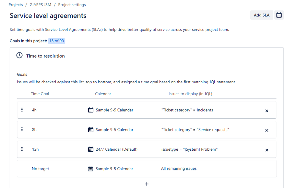

@Win -
"Time to Resolution" field is generated by your JSM project's SLA configuration. You need to review the configuration of your SLA to determine how your issues are setup. There could be multiple goals configured based on different JQL criteria defined.
As you can see in my sample project, I have different rules for "Time to resolution" calculations.

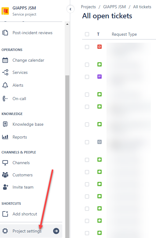

@Joseph Chung Yin & @YY哥 Yang
Thank you so much for your reply, but I'm sorry as I'm new to JSM, I didn't find the project settings page, can you please more detail?
thank you again
To access Project settings, you must be a member of project's Administrators role for the project in question. If you are, then just access your project, then you will see "Project settings" (located at the bottom left of the UI)
From there you can access SLA option setup. If you are not a project's administrators, pleaser work with your site admins and the project's existing Administrators for assistance.
Best, Joseph
