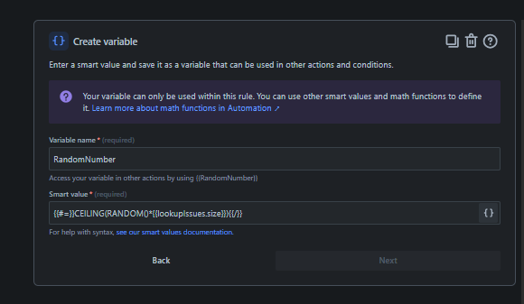

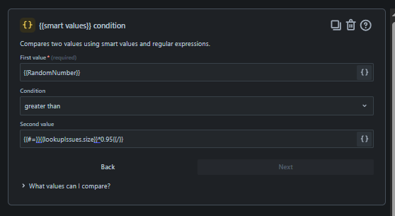

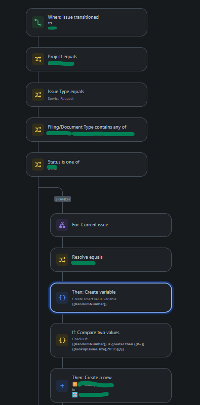

We have two projects A and B. In project A data will be added, project B is quality check. I want 5% of tickets from project A to enter project B for quality checks once ticket is closed in project A. I have created the below rule, please advice me if this is going to work. I have created branch because I need different % of samples for different conditions. Please advice me on variable and its comparison.

Hi @Manav Shah
I assume you're trying to use the logic in this answer?
If yes, it's not an exact science - you're effectively giving the rule a 5% chance of passing the condition, but it's not a guarantee that it'll be 5% exactly.
I also don't think you need to use "Lookup Issues" for this, as it's not based on a set of data, but each single issue's transition.
The rule might look like this (without additional conditions)...
  • Trigger: Issue transitioned
  • Action: Create variable
    • Name = RandomNumber
    • Smart value = {{#=}}CEILING(RANDOM()*20){{/}}
  • Condition: {{smart values}} condition
    • First value = {{RandomNumber}}
    • Condition = greater than
    • Second value = 19
  • Action: Create Issue
^ So essentially, a random number is assigned between 1-20. And the condition then checks it's over 19 (i.e 20) - which has a ~5% chance of being assigned.

Hi @Manav Shah and welcome to the Community!
That looks quite spectacular. But I am not sure what you are actually trying to achieve as a result.
At a certain point in your automation rule, you suddenly refer to lookupIssues, but I don't see any point in your automation rule where you perform the lookup Issues action. If you don't perform a lookup of a set of issues first, the {{lookupIssues}} smart value will just return nothing. So no, I don't think this is going to work.
If I understand what you are trying to do (randomly generating a number of issues for testing based on an unknown number of issues in another project that might be ready to test) I can't think of a way to automate this. It would be much easier if you could build a ready to test status into the workflow of your Project A, you can easily select the issues that need to be reviewed one by one, thus drastically reducing complexity.
Hope this helps!
