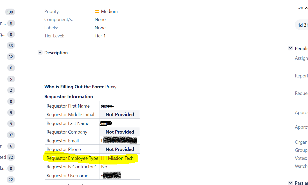

We have a case where depending on a value within our ticket we can skip a step in the workflow. Below is a picture of the field that holds the value "Requestor Employee Type", based on the value of that field is whether or not we would like to skip a step in the workflow. I looked into the automation rules but I can't seem to find a way to have the rule look at that value.

Hi @Monica ,
This should be possible in an automation rule. It is difficult to tell in your screenshot but is Request Employee Type HII Mission Tech text inside a table in the description field? If so and assuming it is a text value and not a screenshot of a table you will need to use Regex to extract the value you are looking for and store it in a variable inside your automation rule. here is a link to help with the regex https://confluence.atlassian.com/jirakb/extract-content-out-of-description-and-summary-with-regex-and-automation-1157495262.html
Inside your automation rule you will need to use the Create Variable Action using regex to get your data. I've extracted data from description before using this method but never data inside a table before so i'm not 100% sure if this syntax is correct but it should be close (it is looking for requestor employee type and then returns everything after this value until the next CRLF):

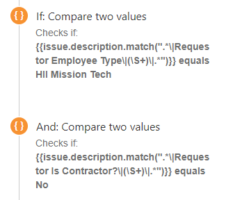

Hi @Kevin Patterson based on I have done it just didn't seem like it was grabbing the date from the Table that is inside the Description.
After a lot of reading, research, and going over this with a coworker we have the feeling that maybe my issue is on how I am trying to extract the data. Here is my latest modification, maybe you can see something that I am missing:
Based on the log, it is telling me that my ticket did not match the condition

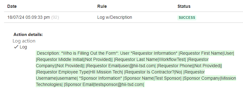

Can you add a Log Action in your automation rule with {{issue.description}} in the log message. I suspect there are special characters in the description that might be causing you headaches with this. once we know what is there we might be able to adjust your compare, or even remove the chars completly with  issue.description.replaceAll
Monica
July 18, 2024

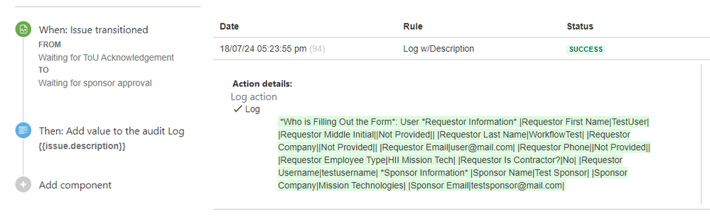

Here is what I get from Description on the log:
Description: *Who is Filling Out the Form*: User *Requestor Information* |Requestor First Name|User| |Requestor Middle Initial||Not Provided|| |Requestor Last Name|WorkflowTest| |Requestor Company||Not Provided|| |Requestor Email|user@hii-tsd.com| |Requestor Phone||Not Provided|| |Requestor Employee Type|HII Mission Tech| |Requestor Is Contractor?|No| |Requestor Username|username| *Sponsor Information* |Sponsor Name|Test Sponsor| |Sponsor Company|Mission Technologies| |Sponsor Email|testsponsor@hii-tsd.com|

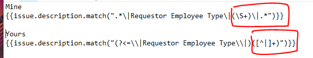

If you don't mind me asking, I see that on my original code towards the end it is very different to what you had. Would you be able to explain why that is, I am trying to understand it given many examples online have it done my way.
Kevin Patterson
July 20, 2024
Both of yours and mine are valid approaches, I Think the reason yours was not working as expected was that the Jira automation Smartvalues has some reserved characters that would have needed to be escaped. Most examples online do not account for this, which is why google searching and LLM bots might give you results that don't work in Jira Automations. You'll noticed in my example that I have \\ instead of the single \ in your example. Some characters are used in Jira Smartvalues that also need to be escaped so you will need to add a 2nd \ to accomplish this.  My approach uses a Lookbehind Assertion (?<=\\|Requestor Employee Type\\|) I do this just in case the text string "Requestor Employee Type" happens to be the value in another field. here is a good reference site that explains it a little: https://www.rexegg.com/regex-lookarounds.php
