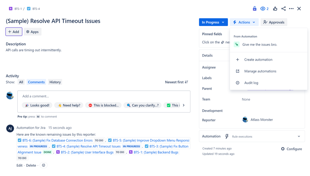

@Andreas Bruckauf  Hello.
What you are asking will require a custom solution as Forge App for example: https://developer.atlassian.com/platform/forge/getting-started/
You can use the solution by Tomislav and get the data from the JQL to display inside the issue with custom app.

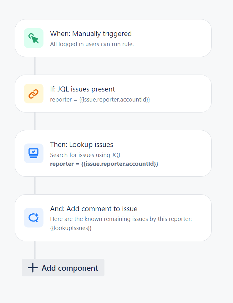

Alternative solution will be to add a comment or edit the description in some way with Jira Automation to do the following:
Trigger: " Select a trigger that will activate the rule" (A manual triggering will be best here)
I hope this partially helps with your question. If that's the case be sure to accept it as solution or ask me for additional help :)

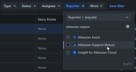

Do you want to display all issues/tickets from the same reporter within the JSM queue, or are you using a global Jira issue search?
In any case, you can use basic or advanced searching to filter out issues that have been reported by a specific user and are in open status (for example).
If this isn't what you meant, could you please describe your question/request with some additional details?
