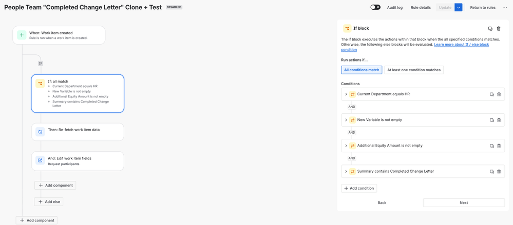

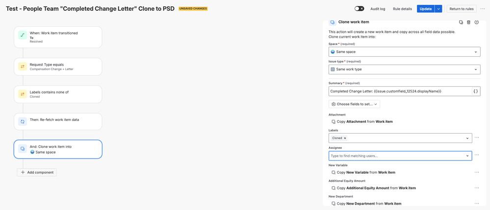

Thanks for your response, Bill. I have two rules, the first to clone, the second to action on the clone.
The first screenshot is the rule which clones the ticket. All elements here happen successfully in multiple tests.

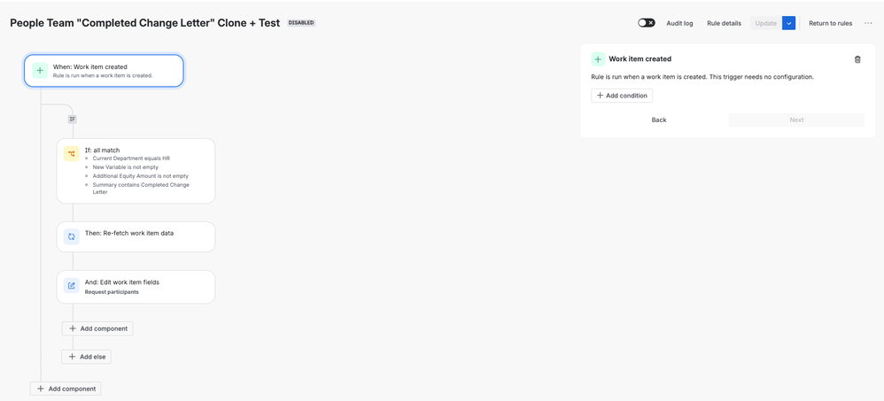

The second screenshot is the subsequent rule basing automation on the cloned ticket. I've asked it to see if all of certain fields match, and if they do, to add request participants. This has consistently failed.
I've added a third screenshot showing more detail of the If all match rule, and the audit log showing "Success" though no participants were added.
(I've turned off the rules when not actively testing.)

In your second rule named People Team "Completed Change Letter" Clone + Test:
  • You want this rule to run in response to the work item being created by the first rule, correct?  If so, did you select the option in the second rule's details to allow rule triggering by others:
Check to allow other rule actions to trigger this rule. Only enable this if you need this rule to execute in response to another rule.
  • Next, the Work Item Created trigger can have racetrack timing problems where the rule can start before the data is ready for use.  The mitigations for that are:
    • Immediately after the trigger, add the Re-fetch Work Item action before any other steps.  I see you have that later in the rule but it should be moved up earlier.
    • And, although you do not do this in your rule, never use conditions inside of the trigger.  The racetrack timing defect will cause the conditions to be unpredictable.
Like • mruttan likes this
Justin Goodemoot
March 2, 2026
@Bill Sheboy Allowing rule to be triggered by others must have been the thing - it works now! Thank you so much! You made my day.
