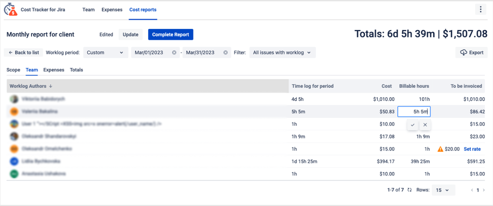

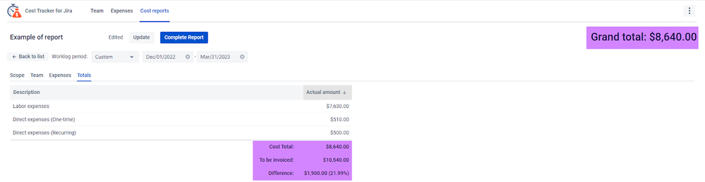

Iryna Komarnitska_SaaSJet_
April 12, 2023
Hi @sergio.peschiera ,
I recommend you use the app developed by my team Cost Tracker for Jira Cloud.
Recently, we added an invoice generation feature to it.
In it, you can generate informative cost reports where everything will be calculated correctly.
Examples of reports:
