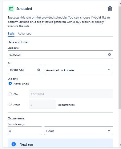

I recommend you use a Schedule trigger like this:
That will start the rule running at 10 am (Los Angeles time) on Monday. The lower portion will run the rule every 6 hours.

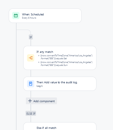

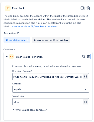

You'll need to use an IF-ELSE block so that you can apply multiple conditions to see if it is in the black out period and proceed with the rest of your rule if it is not.

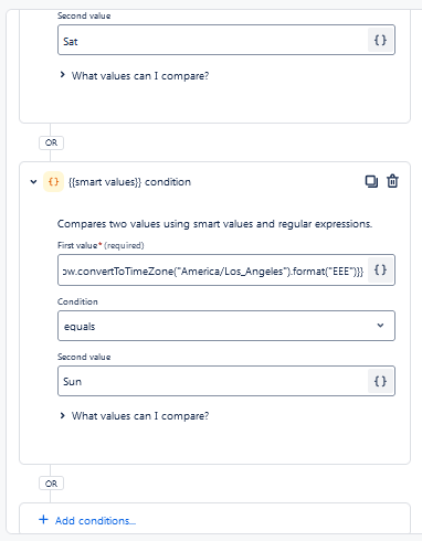

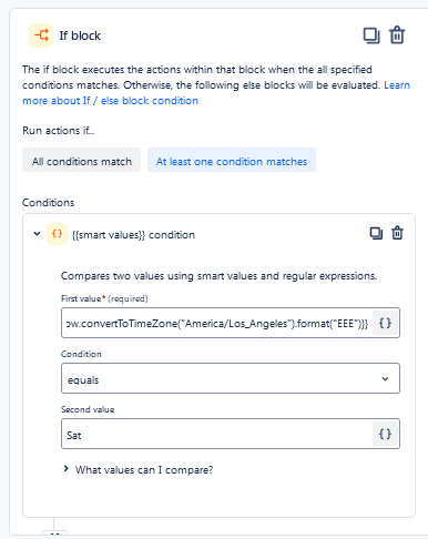

In the first IF block you will check if the current day is Saturday or Sunday. If it is you don't want to run the rule.
The smart value to extract the day of week from the current time, with a conversion to relevant timezone, is:
{{now.convertToTimeZone("America/Los_Angeles").format("EEE")}}
In this case you don't want to run the main actions of the rule, but you must run some action. So add a Log action to log a message of your choice to the rule execution audit log.

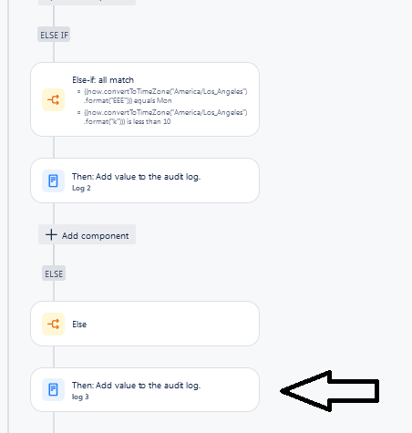

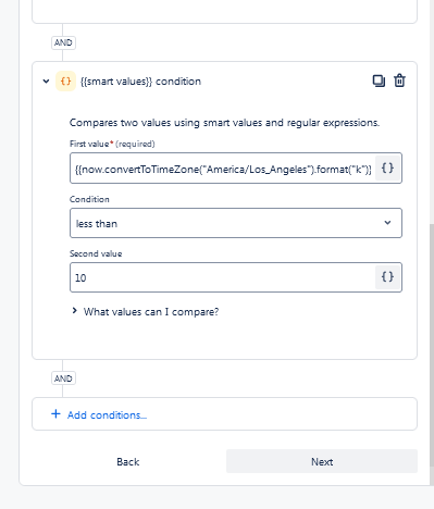

Insert an Else-If to check for the next blackout condition; is it Monday and before 10 am.
The smart value to get the current hour of the day, with the conversion to the relevant timezone, is:
{{now.convertToTimeZone("America/Los_Angeles").format("k")}}
Again, since this is within the blackout you don't want to execute the main actions of your rule but you must execute some action. So add another Log action..
Lastly add the last Else after which you add the actions you want to execute for your automation.
