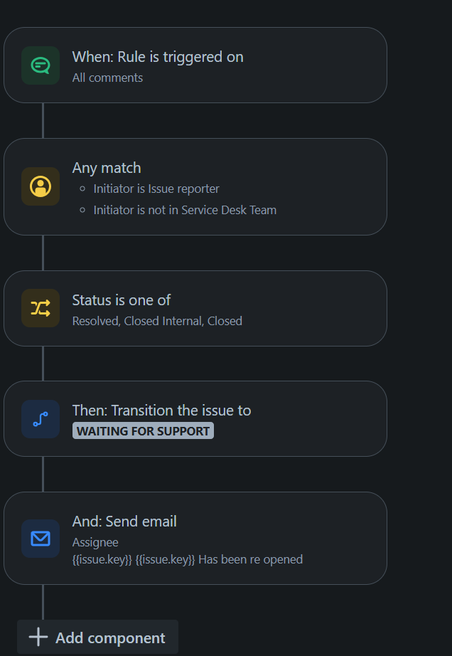

I am trying to create automation to re open a ticket when it is in a closed status. Right now, no comment is made when the customer replies and therefore the automation doesn't run.
The fact that the email from the requestor does not show as a comment in the ticket, and the fact that there are no errors in the audit log make me believe there's something preventing comments on closed tickets.

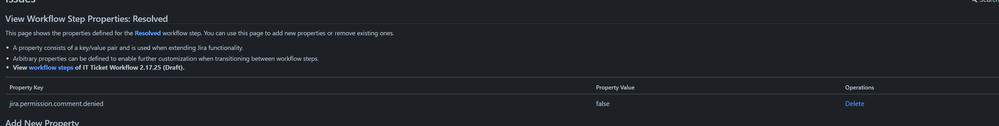

That being said, I checked the properties of my closed statuses and nothing is set to deny comments

hmmm, check any workflow properties for that status then to see if Comments are blocked. I have never seen it prevent you from adding Comments like that. I will try to research also.

This looked super promising but alas, there were no properties set. I then did enter this property to make it false but the same result happened.

Okay, I would take out the property and be sure to publish the workflow again. Once you do that, can you login as that user and go to the issue in the portal? And what does that look like - you can't leave a  comment? If not, can an Agent leave a comment?
