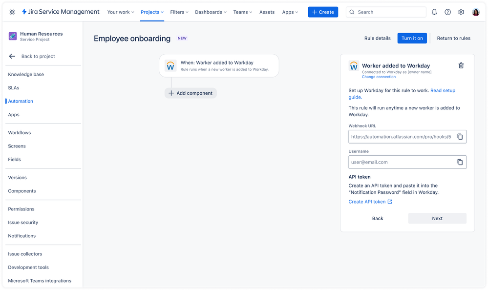

Worker Added to Workday (Trigger)
Use case: When a onboarding tickets are automatically created in JSM.
How it works: Workday pushes a new worker event to Jira Automation, which then triggers your custom onboarding workflow—sending welcome emails, provisioning IT resources, and more.
Smart Values:
This trigger returns 8 default/system fields that with the new hire data which can be used to facilitate employee onboarding.

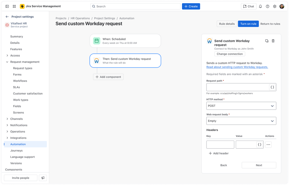

Send Custom Workday Request (Action)
This action allows you to send a custom request to Workday usin methods. Whether you want to access specific data with Workday REST API, retrieve a custom report (RAAS) or send a WQL query, this action can do it all.
Expert tip: Note that requests must be less than 30 seconds before they timeout. This is important to remember when fetching a RAAS report to ensure its size will be processed within the timeout window. You can also use these complimentary with Workday New Hire trigger and Retrieve worker action.
Smart values:
  • {{workday.response.body}} – Returns the response body.
  • {{workday.response.status}} – Returns the response status.

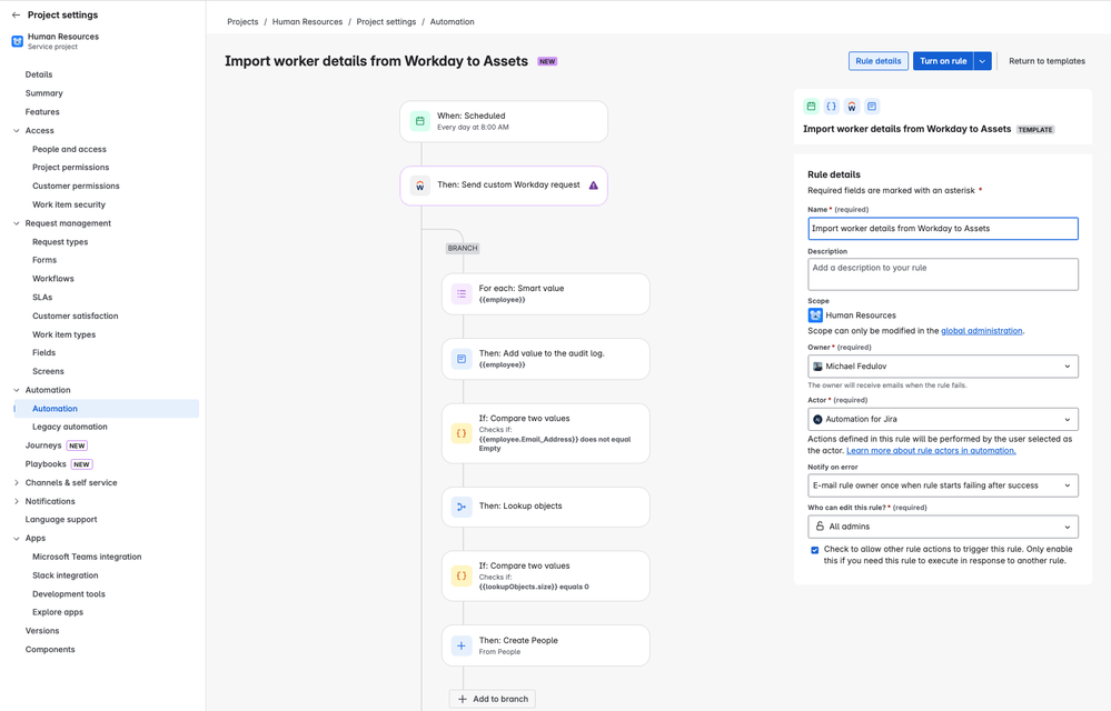

New Template: Import worker details from Workday to Assets
This use case ranks among the most requested by our customers: retrieving Workday RaaS (Reports-as-a-Service) report containing people data to power JSM workflows. To showcase how this can be done, we recently added a new template in the Automation template library to help you get started. This template runs on a schedule and automatically imports employee data from Workday into your JSM Assets using RaaS as the input.
Expert tip: For this template to work, make sure you have an appropriate schema in Assets already configured. In this example we are using Employee schema from People template.
Here’s how this template works:
  • Runs on a schedule (e.g., every morning—customise this step to your needs)
  • Send Custom Workday Request retrieves the RaaS report
  • Iterates through each employee entry with a Branching logic where {{workday.response.body.Report_Entry}} = a new variable called employee.
  • For troubleshooting, it’s helpful to look at what each employee entry looks like in the Audit log.
  • Skips through payload entries without an email field using IF condition.
  • For each employee, this rule performs a check to see if a record already exists in Assets using the email address field from the report data (any other unique identifier will work too).
  • If no related object is found, it creates a new employee record in the Employee schema.

In the post “The Workday Integration BETA has begun!” I had already asked about a status field and possibly the termination date field. I have now tried this action (Send Custom Workday Request) and am getting the corresponding response from the Workday application. However, a corresponding field for status or termination date is not reported back to me. I am not at all a specialist for Workday or the rest api of it. So I don't know which authorizations might need to be available for this. I have not found anything about this in the Rest Api Description (Workday REST Services Directory) either. I can't find how to query a report there either. Does anyone in this article have any tips on this?

Does anyone know how I can use “Send Custom Workday Request” to query a termination date? I can't find such a field in the REST directory of Workday. Furthermore, I cannot find any description of what a filter for this would look like.
https://community.workday.com/sites/default/files/file-hosting/restapi/#staffing/v7/workers

Has anyone been able to get data back using the Worker Added to Workday (Trigger)?
Kyle Jackson
September 11, 2025
Hi @Bryan Gamulkiewicz  Yes I was able to get data.
Bryan Gamulkiewicz
September 11, 2025
Hi @Kyle Jackson  - Was there anything more to it than the instructions that were given?
Kyle Jackson
September 11, 2025
Hi @Bryan Gamulkiewicz  feel free to reach out to me i'd be happy to assist.

This template covers only half of the use case for integration of Workday with Assets - creation of a People asset when none exists.
How do you then keep the People Assets data synchronized to changes in Workday?
I have implement an Automation Rule for this but it is severely constrained by maximum Scheduled Rule cumulative runtime limits and Asset API limits (Burst rate limit) because the Lookup Objects action uses the Assets API.
