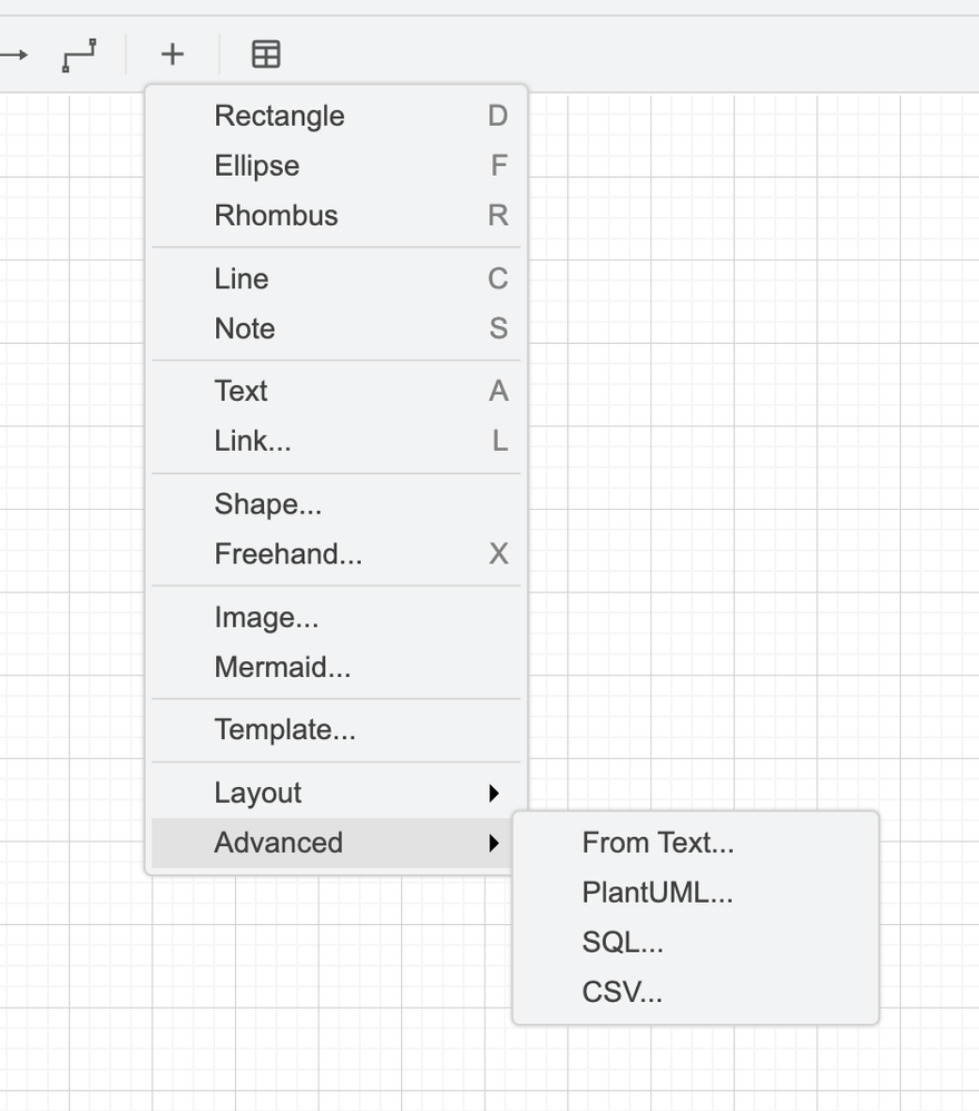

Ken Gunadi
May 16, 2025
Hi,
I know this is an old thread, hopefully anyone can help me.
I'm using draw.io inside Confluence, but did not see the Mermaid option at all under the Advanced menu.
Please refer to the screenshot below.
What does it take to have the Mermaid option? I'm on the free version of Confluence.
Any hints would be appreciated, I've been googling for days without clear answer.
Thank you so much.
-- Ken
stan_kidd
May 23, 2025
I was looking for the same thing under Advanced based on advice from a while back - but it has moved, apparently, to the same level as Advanced - so look at your menu diagram above Advanced and you'll see "Mermaid...".  I tried that and it works to import mermaid code to create an ERD.
