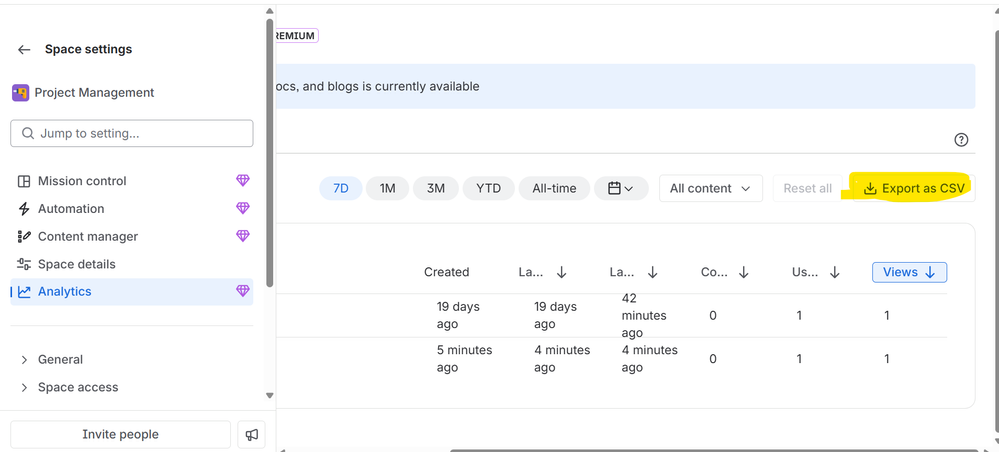

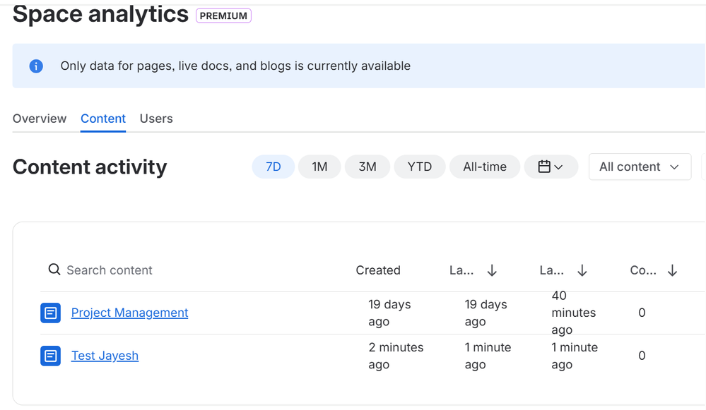

Jayesh Raghuvanshi
October 8, 2025
@Craig_Harley
You can get details from Analytics , see below screenshot
Screenshot 2025-10-08 145135.pngScreenshot 2025-10-08 145354.pngScreenshot 2025-10-08 145419.png
Craig_Harley
October 8, 2025
thanks for this, but how would i be able to pull this into a page properties report?
