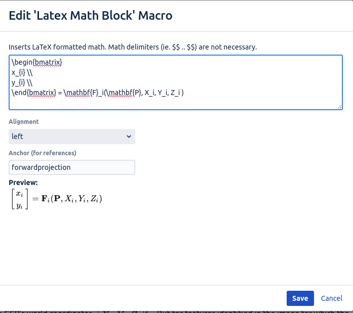

When I click on the "edit" pencil icon to edit the mathblock, I do see the properly rendered equation:
