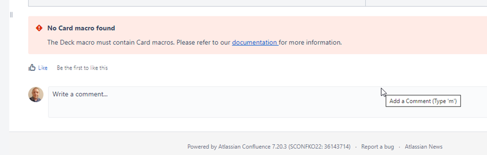

Christian Presslmayr
October 17, 2023
Hi all!
Just encountered the same issue - but it's not reproducible, it happens sporadically on various pages, but for some users only.
So for some user, the page shows an error (see attached screenshot) at the location where the Deck of Cards macro is located. For other users, the same page is displayed normally, so cards (tabs) are showing and working fine.
We are running Confluence Server 7.20.3
Please let me know if there is an issue for this problem which I could watch.
Any other hints or workarounds welcome as well :)
