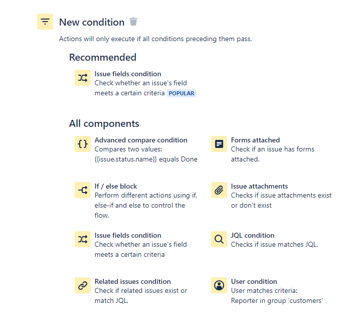

Would it be possible to do this with JQL?

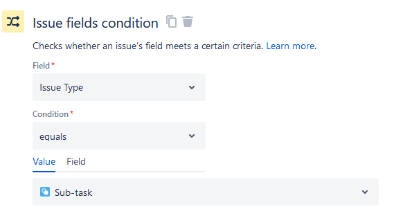

Tim Perrault
June 9, 2023
Both the conditions I used were the Issue fields condition. Are you not able to select Issue Type in the Field section?
But yes using the JQL condition should also work.

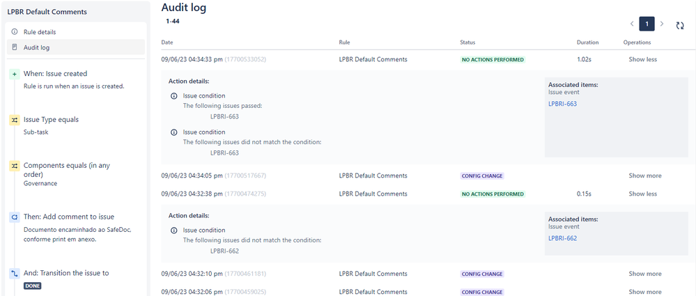

ACTION DETAILS:
        ISSUE CONDITION
        The following issues passed:
        LPBRI-663
ISSUE CONDITION:
       The following issues did not match the condition:
       LPBRI-663
Tim Perrault
June 9, 2023

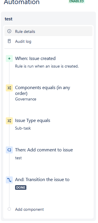

So the rule did not work? Can you post a screenshot of your rule?
Rodrigo Xavier
June 9, 2023
Of course.
The 04:32:38 log was generated following your example (your print)
The 04:34:33 log was generated according to the current image.
Tim Perrault
June 9, 2023

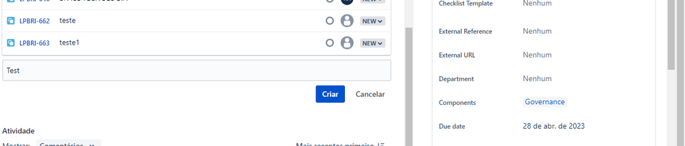

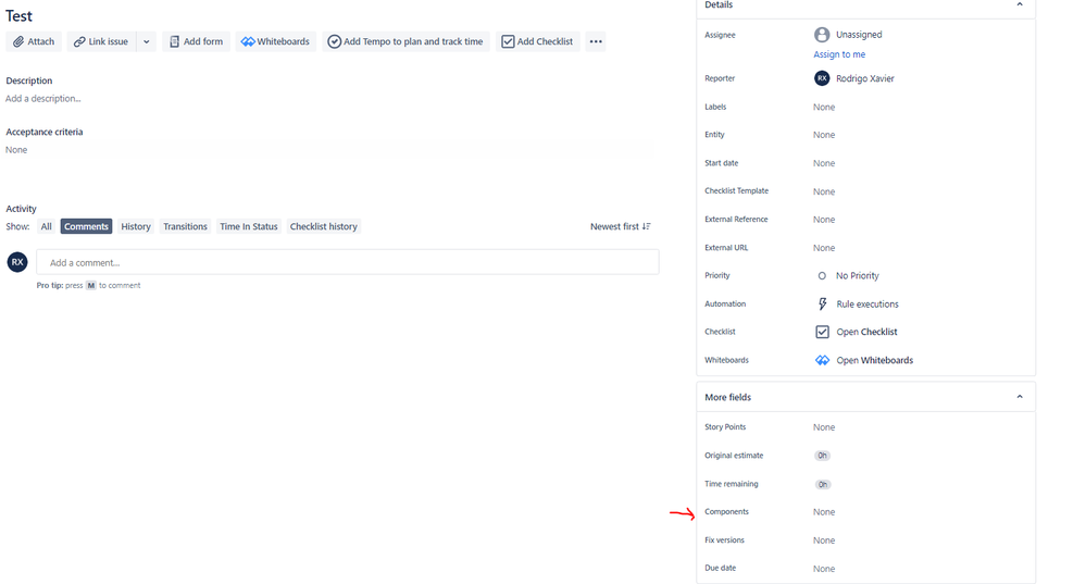

ok it looks like the sub-task LBRI-663 does not have a component when it is created. When you create a sub-task does it have a pop-up screen where you can add the component? Basically the component will need to be on the issue when you are creating it. If you add the component later the automation won't do anything.
Rodrigo Xavier
June 9, 2023
Na verdade, quando a subtarefa é criada, ela é criada sem o campo do componente preenchido, somente depois de criada ela aparece.
Na impressão, a tarefa tem o campo componente preenchido corretamente.
Depois de criar a subtarefa, o campo não é preenchido.
Com base na sua análise, eu já deveria criar essa subtarefa com o campo Componente corretamente preenchido como Governança, correto?

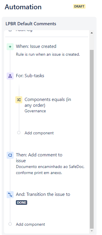

yes the component field will need to be filled in if your trigger is when an issue is created to work. You could use the Field value changed trigger if you didn't want the rule to run on creation.
Rodrigo Xavier
June 9, 2023
Automation this way works, however any subtasks that are created in any component will use my rule.

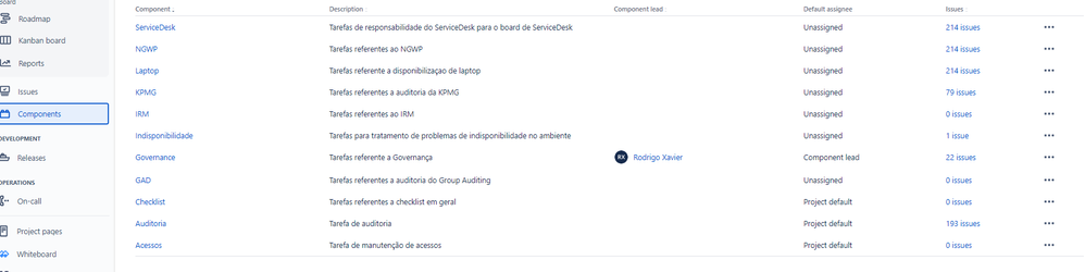

These are the components I have in my project.
And the idea is that the rule only works when subtasks are created in the Governance component.Jira7.PNGJira8.PNG

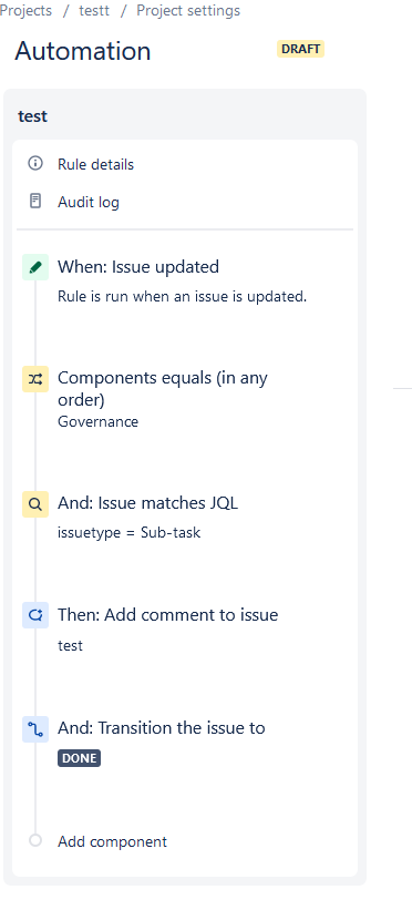

Tim Perrault
June 9, 2023
You could use the issue updated trigger and add the condition for component back. That should work I think.

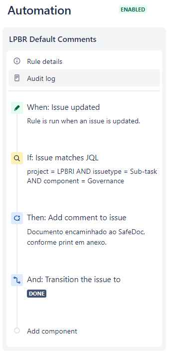

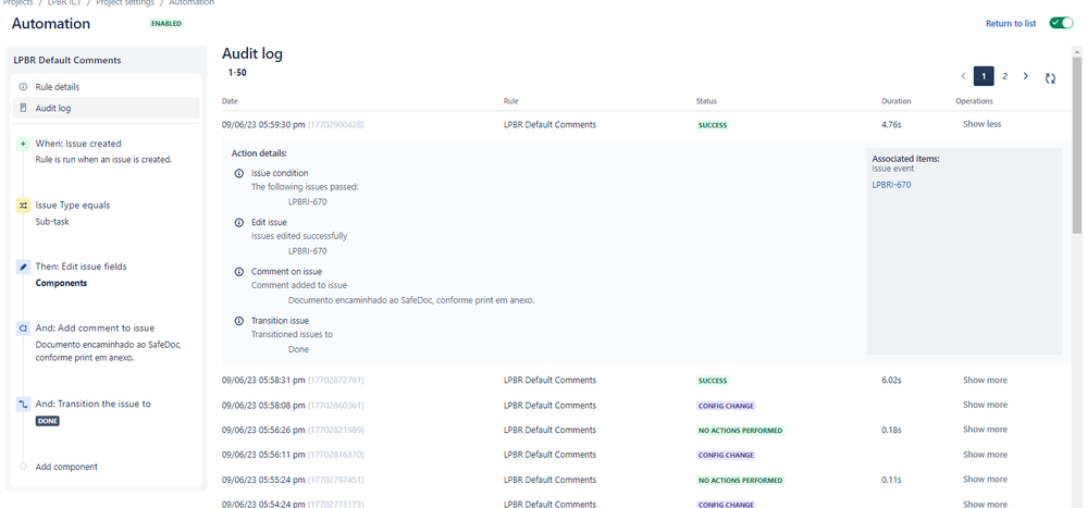

Rodrigo Xavier
June 13, 2023
Hello @Tim Perrault @Hana Kučerová everyone, everything good?
Tim managed to do the automation here.
I left it that way and even acted ps other teams didn't complain about subtasks being automatically closed, so I believe I managed to reach the desired result. Now just refine the code.
Thank you very much for your partnership and help. Automation was like that.

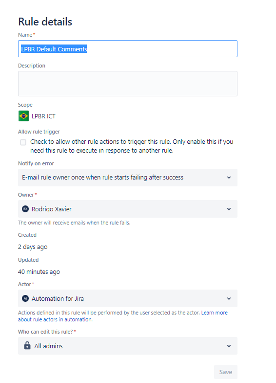

I believe what you need is to set the scope of the rule to the single project.
It can be found in the Rule details section.
Rodrigo Xavier
June 9, 2023
Hi @Hana Kučerová
Thanks a lot for the quick feedback.
I had looked before but I didn't find any relationship.
Hana Kučerová
June 9, 2023
Thank you.
I can see the scope is ok - single project LPBR ICT.
I didn't understand you correctly.
Probably @Tim Perrault is right, you need to add condition with your component.
