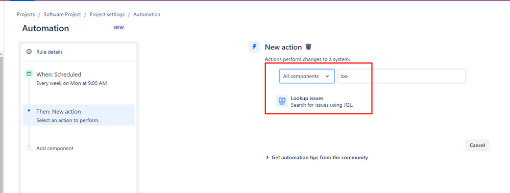

Hi @Kunal Kumar
What do you mean you don't have? I mean on jira automation this is a standard component:
Can you please share a screenshot of what you see?

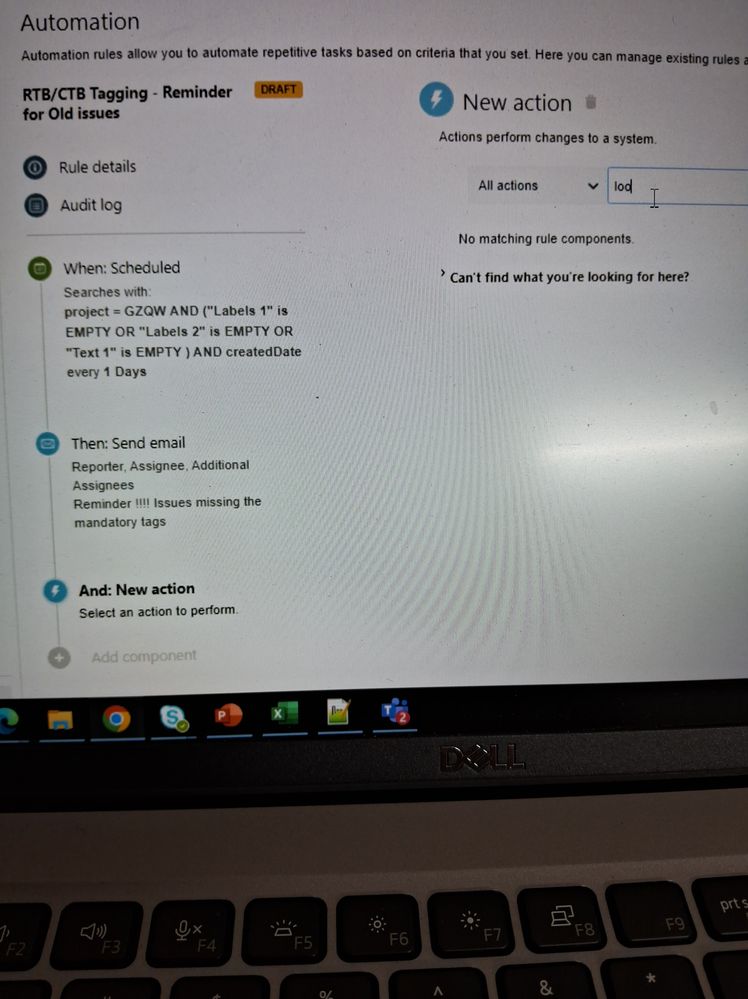

Kunal Kumar
April 3, 2023
@Alex Koxaras -Relational-  Please see below Nothing comes up as lookup under the actions
April 3, 2023
@Kunal Kumar you are on Jira server and not on cloud. Lookupissues is not available on jira server, but here's an issue which you can watch https://jira.atlassian.com/browse/JIRAAUTOSERVER-53
The above issue is in progress, meaning that it could potentially be in the next release.
