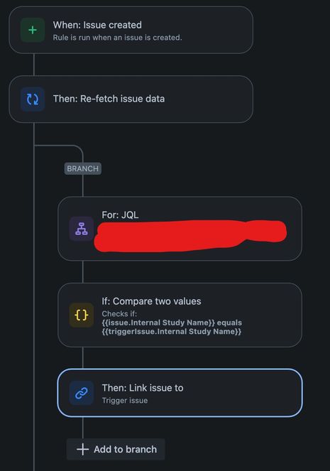

Hi Everyone,
We're trying to set-up a Global automation that will compare the value of a custom field found on the trigger issue and on all of the issues queried in the below filter. If the value is the same on any of the issues within the query and the trigger issue, a link will be created between the two tickets.
The "For: JQL" section is:
project = "ABC" and type= "IssueType" and status="Open" and "customField" is NOT EMPTY
The issue with this automation is that it sort of works. For some reason, it'll also affect new tickets that don't even have that custom field.

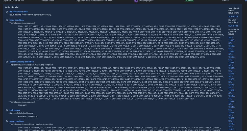

Would you please show the audit log details with the rule execution?  Looking at that, and an example issue with this symptom may help.
What is the type of that custom field: text, single select, multiple select, etc.?
Also...if you add that condition directly to your JQL the rule condition will not be needed:

Hi Bill, thanks!
Yeah no probs, it's quite the big screenshot sorry
All those STU tickets from the JQL query. the custom field in question is a "Select List (multiple choices)". and this is what I get from the link you provided: "customfield_10388": "Internal Study Name", Screenshot_19-4-2024_134115_cogstate.atlassian.net.jpeg

Did you expect to get that many issues back?
If you manually test that JQL outside of the rule, with an example value for the field, does it only return the issues you expected?
Finally, do you mean that custom field is single select or multiple select?

Sorry for the delay! But yes it does look right since it should be over 200 tickets. And I'm actually just now realising it's a multiple select field. Does that change how the automation would behave (vs. having a single select).
