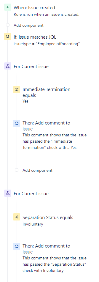

We are building a workflow that will need to execute a couple of different actions depending on different field checks.
As I understand it, you would use branching to achieve this but I can't seem to get it working.
For testing purposes, I was just trying to have the automation make two different comments on the triggering issue based on if two different fields had a specific entry. Here is screenshot of what I have.
The final automation will be creating linked issues in different projects based on those same two fields, but this was built to see if the branching was working in the way I assumed it would work.
Am I using the wrong branching or would I have to do this in a different fashion?

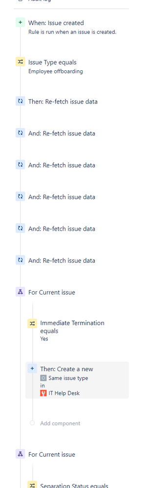

So the suggestions in this thread were not working as intended and I ended up having to go to Atlassian Support to figure out why. To be clear, the suggestions given before would work, if we were not using Forms.
We are using the new Form feature to gather data on our customer portal. The automation happens so fast that Jira doesn't have enough time to put the data from the Form into it's linked Jira Fields.
We had to put in several (6) Re-Fetch data actions at the start of the automation in order to give Jira enough time to put the data into the Jira Fields. After that, the automation suggestions worked as intended. We ended up using the Branching option as it was better for grouping for us and makes the flow easier to adjust later.

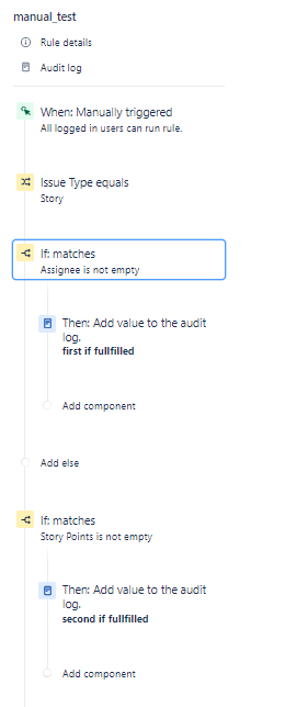

Stefan Salzl
February 18, 2022
From how I interpret your description the a setting similar to following rule should meet your requirements (see screenshot)
I tested on my site:
  • if both fields are empty --> nothing is processed
  • if assignee has value, Story points is empty --> only action for first "if" is processed
  • if assignee is empty, Story points has value --> first action is not processed, only action of 2nd if is processed
  • if both, assignee AND Story points have value --> BOTH actions will be processed
Hope this helps.

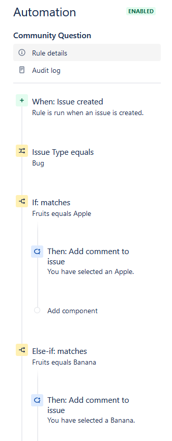

Adrien Low _ServiceRocket_
February 18, 2022
Hello @David Quiram ,
Based on your requirements, it seems that you are looking for the If / else block condition.
A sample configuration as below:-
Hope this helps.
Regards.
David Quiram
February 18, 2022
It was my understanding that if the issue matched the first IF condition, then it would follow that path, make the comment, and then exit the automation. Is that not correct?
Given your example, what if the user selected Apple AND Banana?
