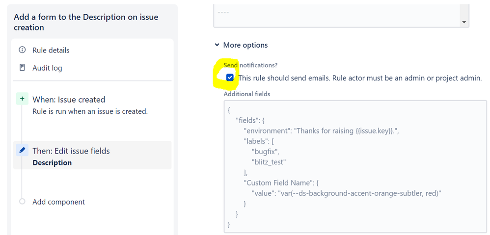

Ignacio Pulgar
March 1, 2023
Alex Koxaras -Relational-
March 1, 2023
I had totally forgotten about this! @Ignacio Pulgar is right. Try this instead!
Good job Ignacio!
Like # people like this
Mike D_
January 24, 2024
I don't see that option, what am I missing? 🤔

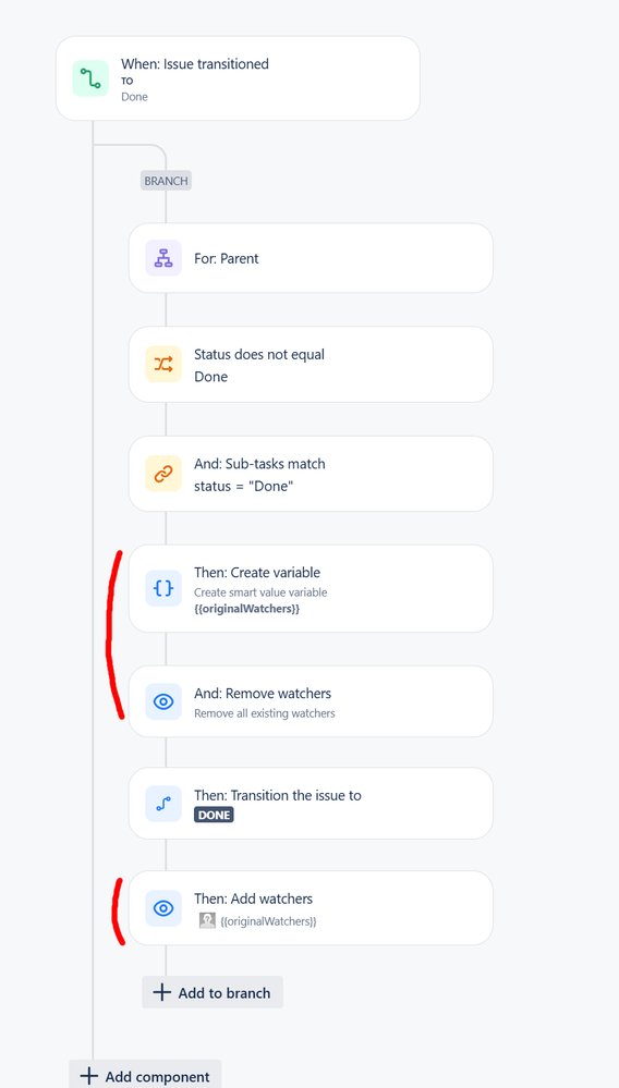

Hugo Ludinant
February 25, 2025
Hey @Sweder Reuchlin
Here is the whole setup:
Haven't tried with other changes than editing the parent of an issue, but in theory it'll work just as well in another context.
Hopefully this helps!

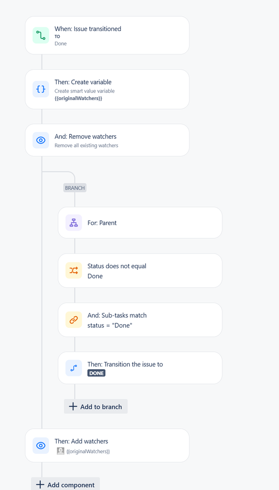

Sweder Reuchlin
March 3, 2025
Hi @Hugo Ludinant ,
Thank you for the screenshot.
Unfortunately I still get a notification when the status of the parent is changed. This is how I have set it up:
Can you see if I am missing something?
Thanks!

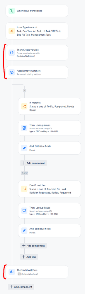

PatateNouille
March 3, 2025
Hi @Sweder Reuchlin
In my case I was modifying the issue that is getting transitioned, which is why I had the watchers actions on the main branch.
However I think that since you're modifying the parent of the transitioned issue, and not the issue itself, you'd need to put the actions on that branch.
Something like this:
I'm not sure if the actions would need to be adjusted, in theory the "Remove/Add watchers" actions will work, but there's a chance the smart value used in "Create Variable" picks the wrong issue.
I'd try with {{issue.watchers.accountId}} first, and if it doesn't work look for a potential special smart value to refer to the branch's issue?
Sweder Reuchlin
March 3, 2025
Hi @PatateNouille ,
Thanks for jumping in on the conversation.
That also didn't fix it unfortunately...
Is there another way to structure the rule so that I don't get notified every time?
Thanks!
