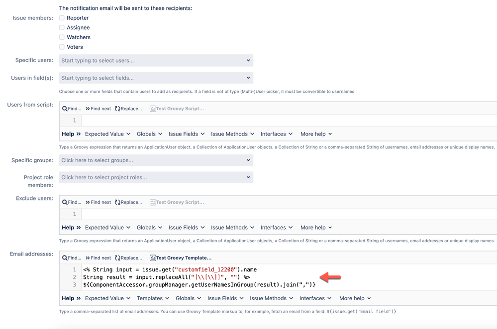

Configure the Email Issue Post function as shown below:
Add the below groovy script in the Email addresses field
<% String input = issue.get("customfield_12200").name
String result = input.replaceAll("[\\[\\]]", "") %>
${ComponentAccessor.groupManager.getUserNamesInGroup(result).join(",")}
The above script gets the email addresses of all users within the group selected in the field.

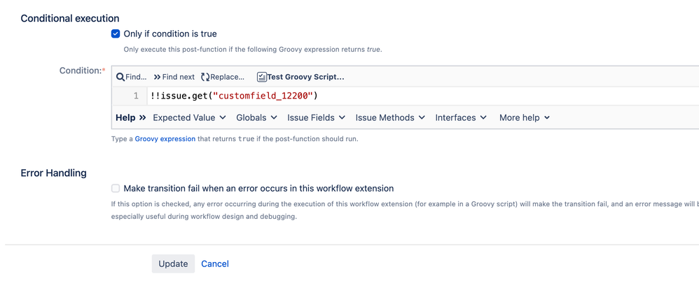

Add the conditional execution as shown below to send the email only when the group picker field has some value.
!!issue.get("customfield_12200")
customfield_12200 is the group picker field. Please modify the ID as per your instance.
