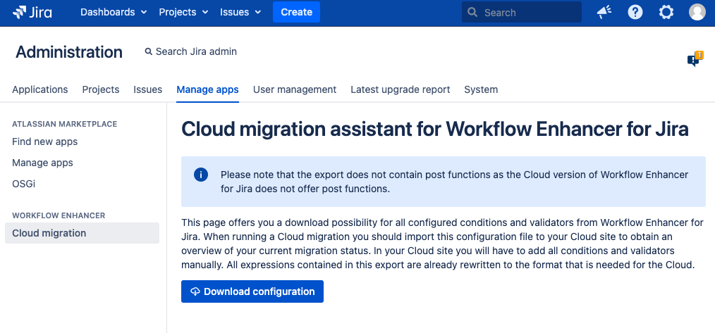

Firstly, you can download the full data of the Workflow Enhancer configuration from your Server instance as a JSON file.
Then, you can upload this configuration file on our app’s Cloud migration import page on your Cloud site.

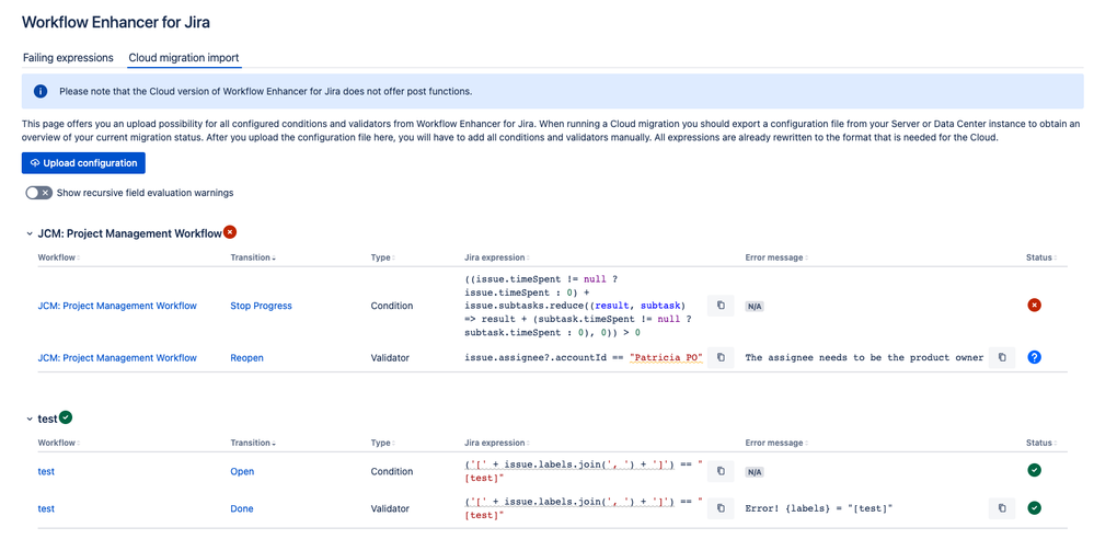

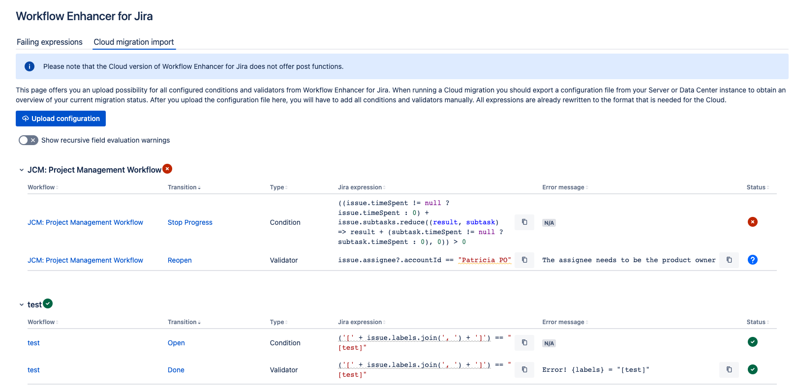

This will show you the current status of the Workflow Enhancer’s migration. It will list for you all workflows that contain workflow transition rules of the Workflow Enhancer, the respective transition, their type and the content of the elements in the format that is necessary for the Cloud version. In the final column, it will display the status, i.e. whether the rules have already been configured correctly on the Cloud site or not.
Unfortunately, Atlassian does not provide an endpoint to directly create the workflow transition rules automatically, so you will need to click on the link to the Transition, add the Workflow Enhancer condition or validator there, and copy the necessary configuration inside.
We took the extra mile and made a smart conversion with giving as many hints for the new Cloud format version as feasible on the underlined parts. Many things will change between Server and Cloud formats - and the Cloud version is much cleaner which you will appreciate. You can also have a look with our code editor when entering the new expressions which you hopefully will enjoy as much as we did building it!
Some hints need to be fixed by yourself due to the fact that we do not have the information from the Jira Migration assistance present. For example, in the server version, Workflow Enhancer for Jira compares fields to the username of a user. In the Cloud, the username property is replaced with the accountId, but this mapping is only known to the Jira Migration assistant, meaning we cannot get this information. This has to be done manually by the user, at least until Atlassian provides access to the Cloud migration assistant for Forge apps.
