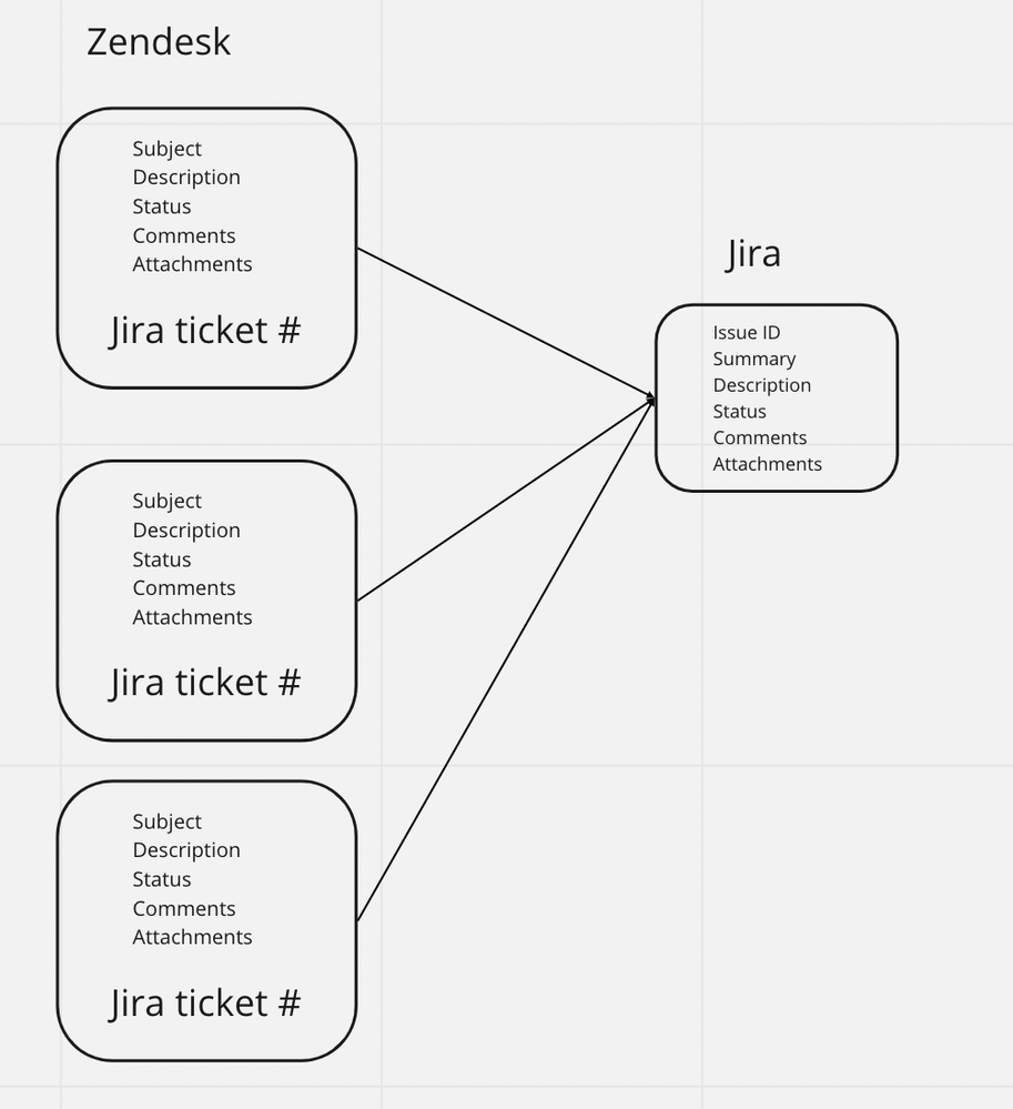

The Use Case
A customer wanted to sync multiple Zendesk tickets (raised by their customers) to be reflected in a single Jira Cloud work item to be taken up by the Dev team.
Also, once the status on the Jira work item has been marked as "Done" from "In Progress", the corresponding status on the Zendesk side would be changed to "Open" from "New".
A custom field called "Jira ticket #" is used as an identifier for the work item on the Jira side.
Summary/Subject, description, labels/tags, attachments, and comments need to be synced bidirectionally between the two systems.
This is a common pattern for support teams handling duplicate customer reports. Instead of creating separate Jira work items for each ticket about the same bug or feature request, all related Zendesk tickets funnel into one work item, keeping the dev team focused while support tracks individual customer communications.

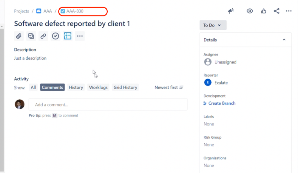

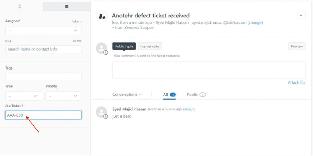

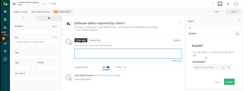

We create a ticket on the Zendesk side and sync it manually to the Jira side. Though this can also be done automatically with the help of triggers.
The work item on the Jira side has the ID: AAA-830.
Remember, this is the ID that needs to be entered on the Zendesk side. So when a new ticket is created, the same ID is entered in the custom field "Jira ticket #".
And when it is synchronized, it gets synced to the same Jira work item we have entered.
