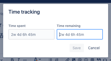

Depending on your chosen estimation method (Cog next to the plan's name -> Scheduling -> Estimation), Advanced Roadmaps will show either a "Story points" field or an "Estimates (h/d)" field. "Story points" maps directly to the "Story points" field on the issue once changes are committed via the Review changes dialog. "Estimates (h/d)" actually maps to "Time remaining" which can be found in the "Time tracking" section on the Jira issue.
The confusion here arises from the fact that updating "Original Estimate" the first time will automatically transfer to the "Time remaining" field, but subsequent changes do not. Advanced Roadmaps does not reference the "Original Estimate" field at all.

Hi, we used a Jira automation to do this. We created a custom field called SWAG which will set the Original estimate and override the Time Remaining if Time Remaining is blank. We do this using Jira automations. the SWAG field can be used in Advanced Roadmaps. It's slightly clunky, because you have to apply changes so the automation can fire. It works OK as you are likely not estimating your size and planning your timeline at exactly the same time. It's basically just a workaround for a poorly designed function in Jira.
