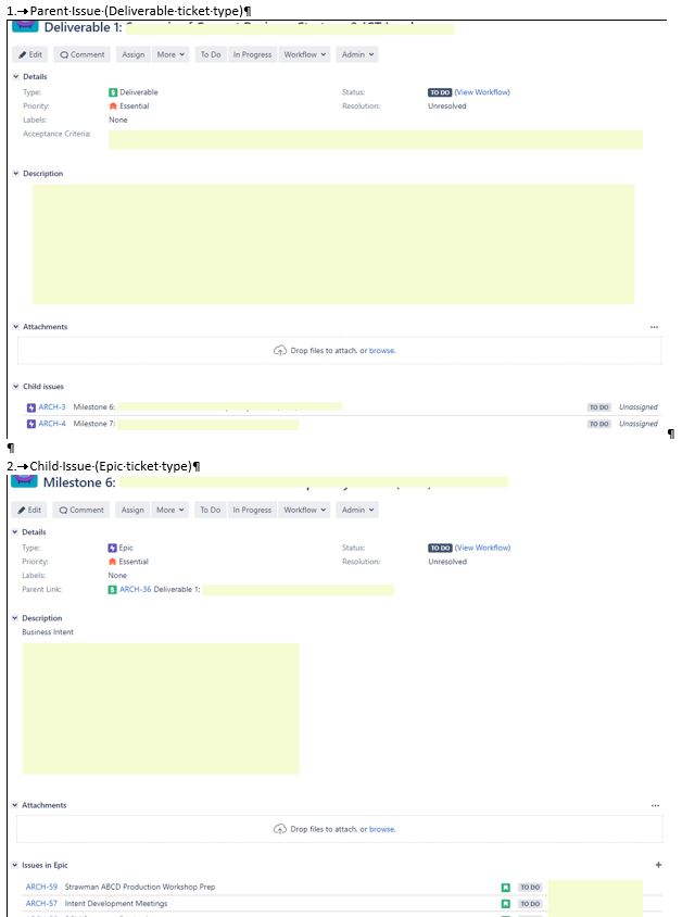

Everything I have read online seems to indicate it is impossible to create a Parent / Child relationship in JIra software (server) without using a plug-in or roadmaps. However, we have an existing project where there is very definitely a set up that an issue type of 'deliverable' then has children that are Epics. The epics then have user stories that are linked as issues in the Epic. Please see attachment (**edited to include this info, as failed to load the first time**).
I am being asked to replicate this structure for another project, however can not figure out how it was done. Also, whenever I use the parent link on another screen, the only projects that appear in the drop down are related to the original 'deliverable' ticket types from the project that created this ticket structure.
The person who set this up is long gone. We do not have, nor have we ever had, roadmaps or a plug in to manage ticket structure.

You say
"We do not have, nor have we ever had, roadmaps or a plug in to manage ticket structure."
That looks like an incorrect statement to me. I think you'll find you have the Structure app installed. The "child issues" panel in your first screenshot is not native to Jira but can be created by Structure.
@Nic Brough -Adaptavist- is correct, @niggles20. You already have Structure for Jira installed.
Our support team — you can reach them via structure@almworks.com — will gladly help you address the use case you described.
