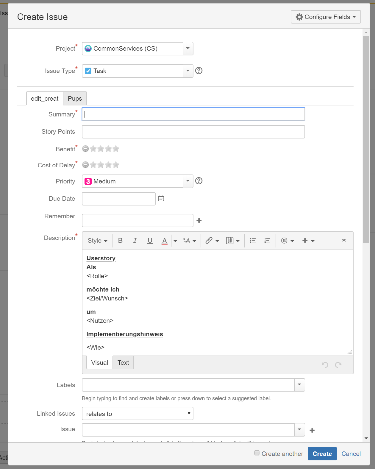

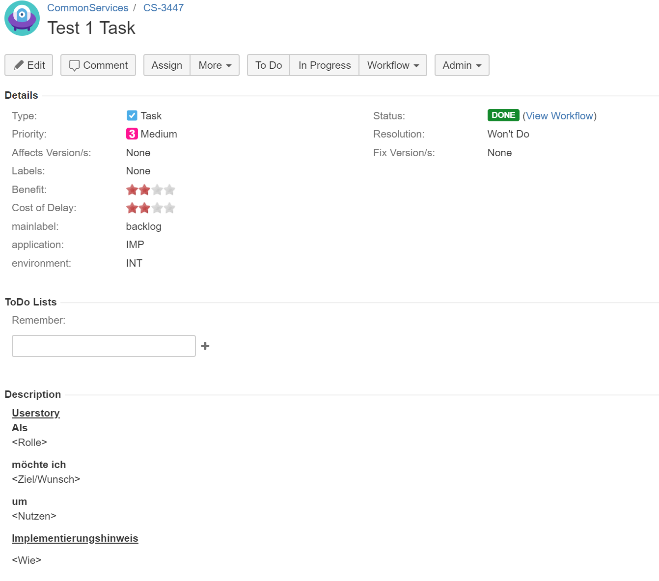

i want use two different Screens for the Standard View of an Task i want use the screen "CS: Screen View" and for the Create Screen i want use the Screen "CS: Screen Edit"
How can i do this? For all other transitions it is no problem. i can add the screen in workflow. But for create it doesn't worked
Create Screen
StandardView:

You need to go and edit the screen scheme that the project is using, from here you define what screen is used for viewing, editing and creating. Go to Administration > Issues > Screens > Screens Scheme. Have a look at Editing a screen scheme's details for more information.
