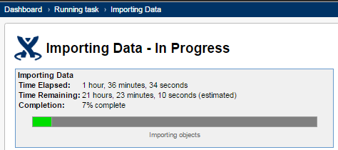

From the application I tried to restore the WIKI Prod backup to test environment but facing the issue i.e. restoring the backup is taking a long time. I have faced the same issue on earlier as well.
Please find the below snapshot:
Please suggest me is there any other possibilities to import the data from Production to Test.
