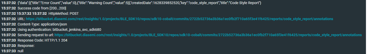

I've been using bitbucket insights for code style reports successfully, for about a year. I am now trying to add a second Static Code Analysis report (invoked from a separate Jenkins job), but it fails. REST operations seem ok, however the additional report is not visible in my PRs.
This is the successful flow:

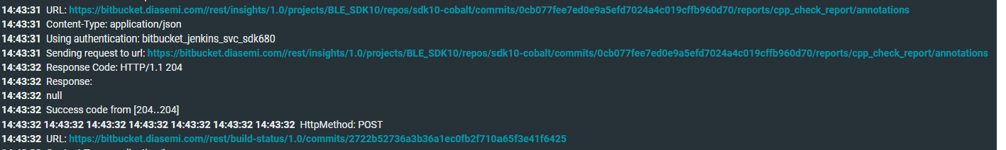

and this is the failing one:
I have cross-checked all data uploaded (cpp check report vs code style report) and its identical in terms of formatting. Any ideas?
Thanks in advance!
Invalid, seems i had wrong commit hashes!
