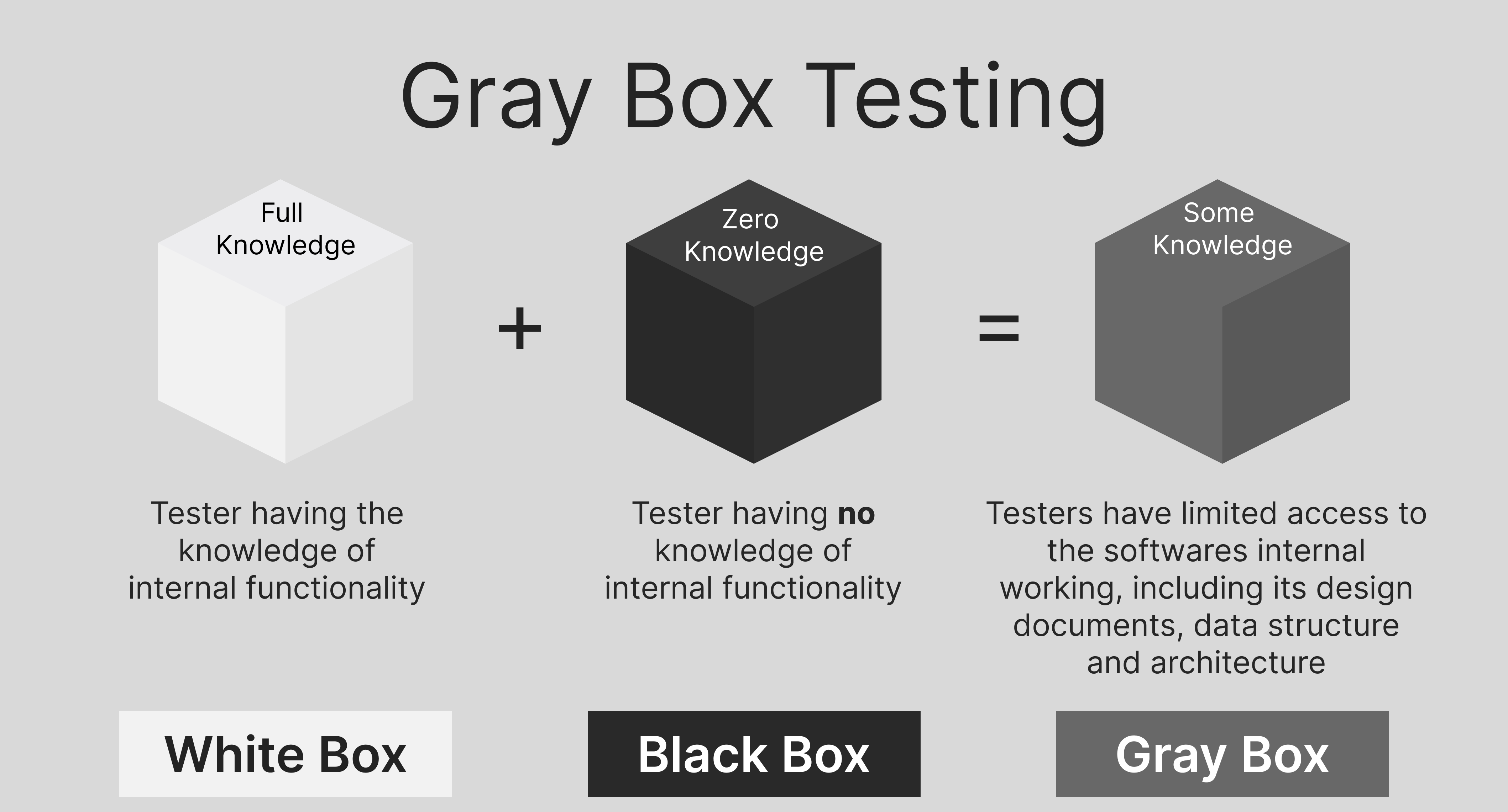

Reproduce a problem scenario with grey box testing
Grey box testing, with its blend of knowledge about the internal structure and external behavior of the software, is particularly effective when it comes to reproducing problem scenarios. It enables testers to utilize their understanding of the software's internals to design targeted test cases that replicate the specific problem scenario.

Grey box testing and how to use it with git bisect - finding the code changes that caused the problem
Grey box testing is a great testing strategy for git bisect as it enhances the ability to reproduce problem scenarios accurately across the commit history.
By leveraging the power of both techniques, developers and testers can streamline the regression testing process and quickly pinpoint problematic code alterations.

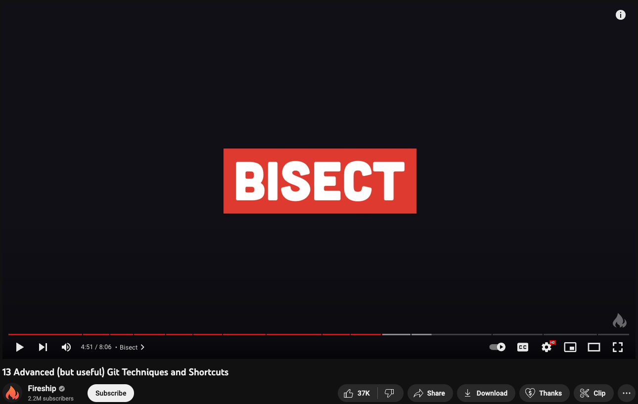

We recommend watching Fireship’s video, where he talks all about Git Techniques, including yes you guessed it, Git Bisect.
