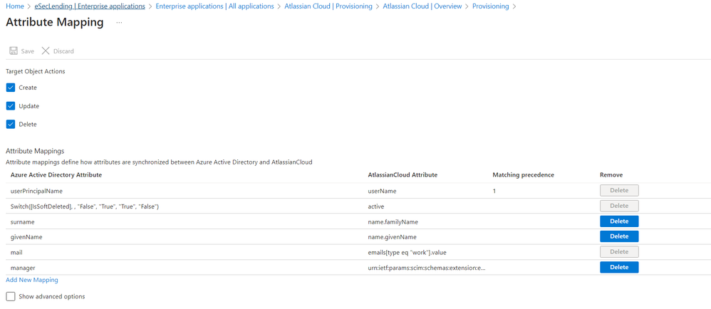

Even after following instructions to sync the manager attribute into Atlas with Azure AD (https://intercom.help/atlas-by-atlassian/en/articles/6872562-how-to-sync-the-manager-attribute-into-atlas-with-azure-ad), we are not seeing correct reporting lines in Atlas.
What else needs to be done?

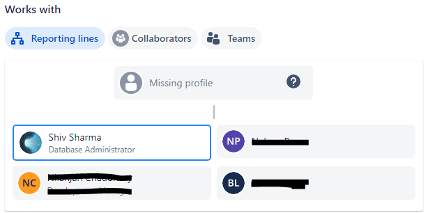

We see a placeholder for employee's manager with "Missing Profile" label and this text:
"Missing profile (Looks like that person doesn’t have an Atlassian account. Ask an admin to add them.)"
It happens for every employee. Obviously profiles are there.
We confirmed that we used the correct target attribute:
 urn:ietf:params:scim:schemas:extension:enterprise:2.0:User:manager

Did you put "manager" in small letter in the mapping? It's case sensitive, it was not working when I put "Manager"
Shiv Sharma
July 28, 2023
Yes, source attribute is "manager".
It gets some/partial info but not the correct mapping as defined in the Azure AD.

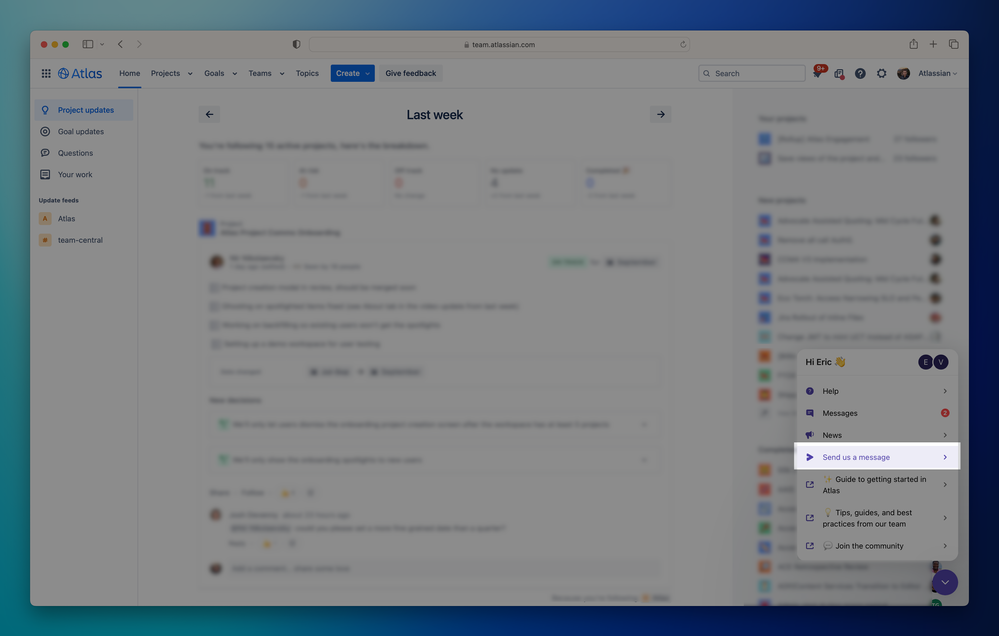

@Shiv Sharma if you click the icon, it should open a dialog with an option to send us a message:

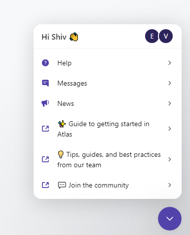

@Eric - Option to send message is not available to me. Maybe because ours is the free version?
 Atlas_help_menu.PNG.
