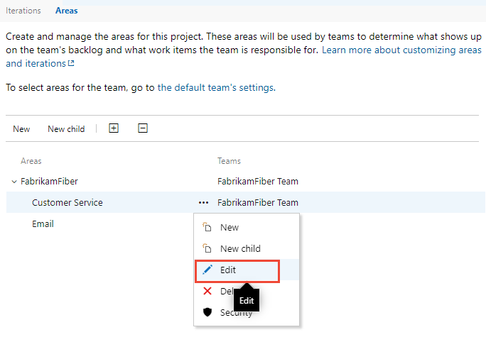

What is an Area Path?
An area path establishes a hierarchy for work items related to a specific project. It helps you group work items based on team, product, or feature.
Organizations working on a product or feature can use area paths to establish a hierarchy between teams at every level of involvement. You can assign the same area path to multiple teams.

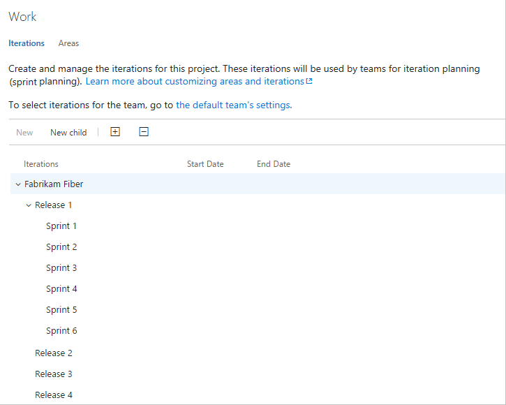

What is an Iteration Path?
An iteration path assigns work items at the project level based on time-related intervals. Teams can share them to keep track of ongoing projects, specifically for sprints, releases, and sub-releases.
When new work items are added to the Sprint backlog, they become accessible via the existing iteration path. You can add up to 300 iteration paths per team.
