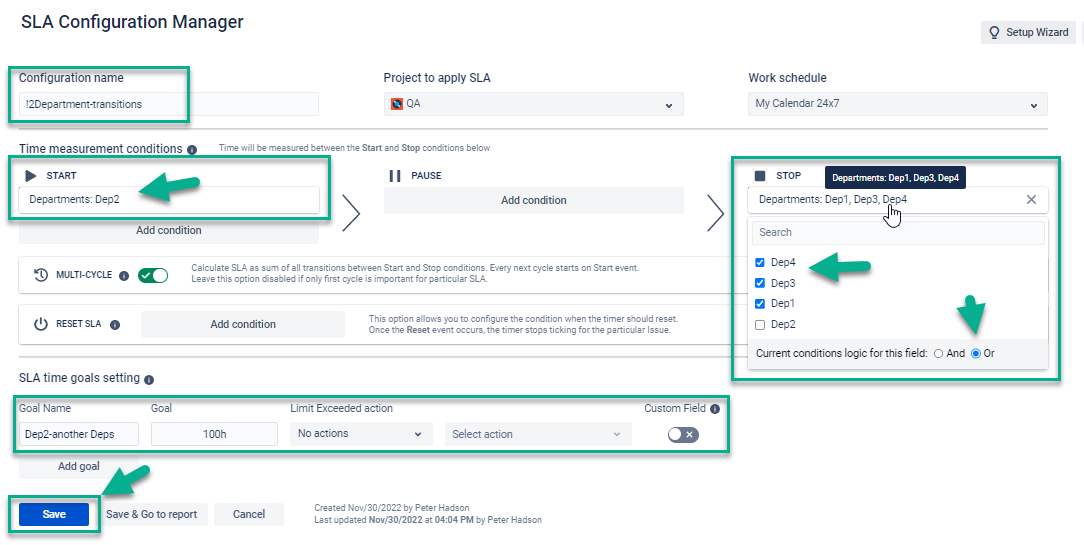

1. Create as many configurations as you have values under your custom field 'Reported group'. You can create custom fields in your Jira settings.
2. For instance, you have 4 values under the custom field 'Departments' (Dep1, Dep2, Dep3, Dep4).

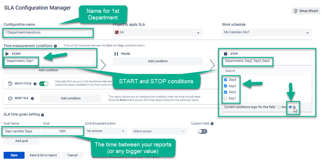

In the SLA Manager, you must create four SLA configurations that Start from the first value and Stop with any of the others.
Save and make a second configuration for the next Department.
The same sense is for the 3 and 4 configurations.
With these configs, as soon as a particular Jira issue has the first value Dep1, the first config runs until this issue changed one value to another. When the custom field changed Dep1 to Dep2, the 2 config run calculates a time, etc.

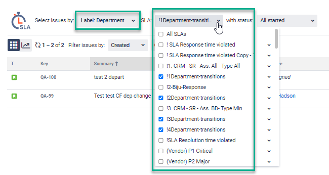

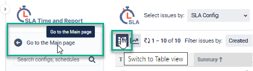

3. Next, Go to the Main page and Switch to Table view.
Here you should select only these 4 SLAs with the Label 'Department'. Just fill in the necessary amount of configs.

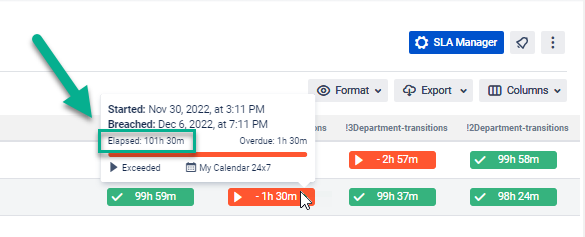

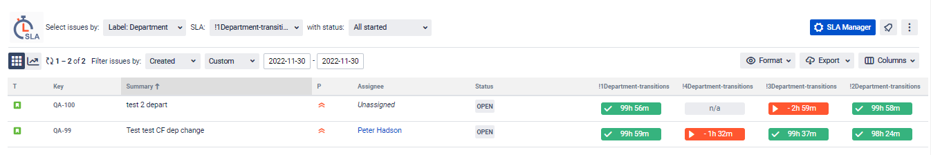

4. And we got a table with the issues remaining time (based on the time goal you input in the config) & elapsed time. The elapsed time lets you know the exact time an issue spent.
In this case, the issue QA-99 spent 101h30 m under the 'Dep2' custom field value.
In the mirror situation, your team 'A' spent N hours N min.

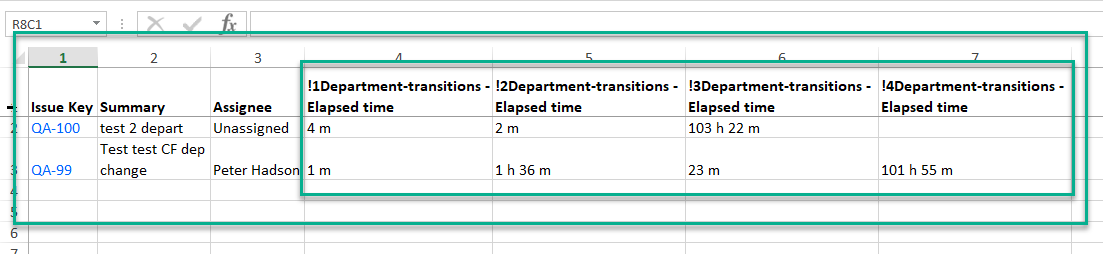

5. If you prefer to get only elapsed time data, just export the table and keep there only 'Elapsed time' columns.
