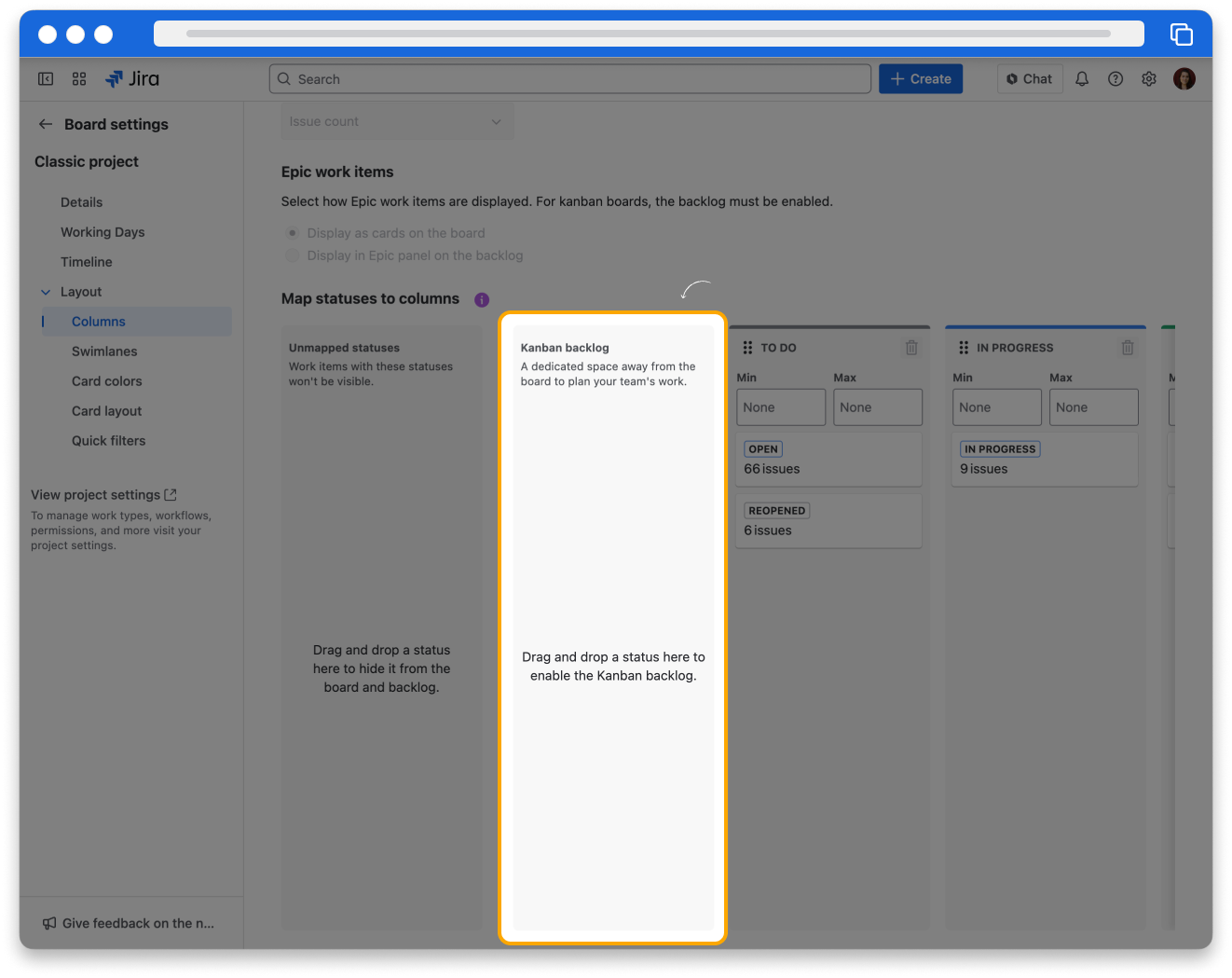

In company-managed projects, by default, kanban boards have a Backlog column on the board, but don’t have a separate backlog area. However, you can enable the backlog if you want a separate place to plan work. With this method, you can easily plan and organize many work items and only include planned work on your board.
To enable a separate backlog:
  1. Open your board.
  2. Next to the board name, select More actions (represented by •••), then Board settings.
  3. In the sidebar, select Layout, then Columns.
  4. Drag the first status column in your workflow (often Backlog) to the Kanban backlog section.
👇 Here's where you can enable a separate backlog.
The columns page of Configure Board settings. The left-most column is the kanban backlog. To the right is another status column that also says Backlog. The the right of that are three more status columns.
