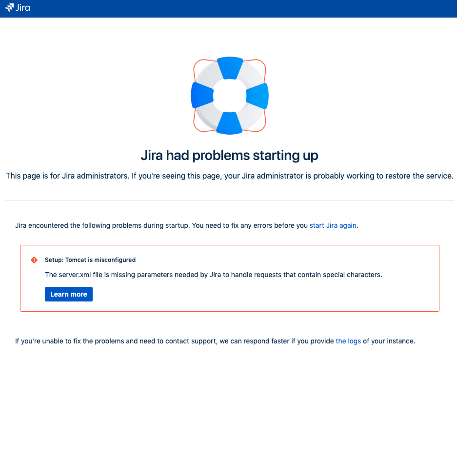

Hello all, super new to Jira and tomcat, but I managed to follow a guide and quickly install SSL, the redirect works, but after following the documentation to add these
Add <span>relaxedPathChars="[]|" </span>relaxedQueryChars="[]|{}^\`"<>" to the connector properties in server.xml
It seems like my Jira software is still telling me what the picture says
Do take note I am self-hosting, provided I have listed the logs from catalina.out, and my server.xml configuration files.

2018-12-22 14:01:10,680 JIRA-Bootstrap ERROR [c.a.j.health.checks.TomcatConfigurationHealthCheck]
Required path chars: [ ] |
Configured path chars: null []|
Required query chars: [ ] | { } ^ \ ` " < >
Configured query chars: null []|{}^\`"<>
2018-12-22 14:01:10,704 JIRA-Bootstrap ERROR [c.a.jira.health.HealthChecks] Tomcat is misconfigured
2018-12-22 14:01:10,704 JIRA-Bootstrap ERROR [c.a.jira.health.HealthChecks] The server.xml file is missing parameters needed by Jira to handle requests that contain special characters.
2018-12-22 14:01:10,704 JIRA-Bootstrap ERROR [c.a.jira.startup.DefaultJiraLauncher] JIRA has failed to start because of the following errors: [(Event: Level = (EventLevel: error) , Key = (EventType:$
