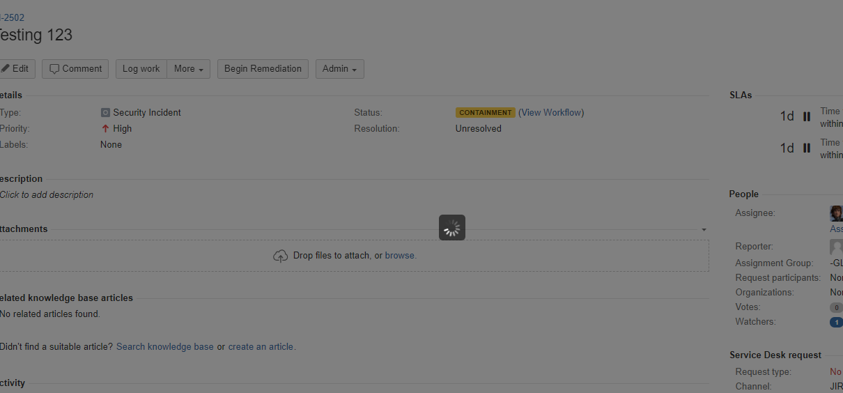

The Create/Edit Screen not popping When I open a Project / Issues its showing page loading
this is happening only when i open a projects and issues and when i right click on create and edit and open in new tab its working
when i click directly its not working as shown in screenshort attached

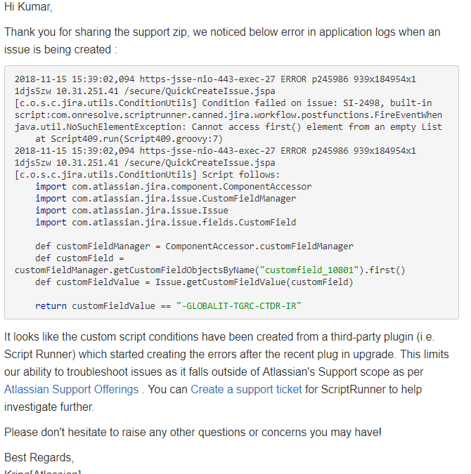

i have raised a ticket in atlassian they response is showing in screen short and when i looked at the logs its saying script runner error
This is happen after i update the add-on only if i disabled it its working but i have done some task with script runner so i don't want to disable it.
Error Log:
20-Nov-2018 19:47:38.427 WARNING [https-jsse-nio-443-exec-15] com.sun.jersey.spi.container.servlet.WebComponent.filterFormParameters A servlet request, to the URI https://jiradev.cargill.com/rest/activity-stream/1.0/preferences?_=1542743258394, contains form parameters in the request body but the request body has been consumed by the servlet or a servlet filter accessing the request parameters. Only resource methods using @FormParam will work as expected. Resource methods consuming the request body by other means will not work as expected.
Can you please help me here how to resolve this issue
