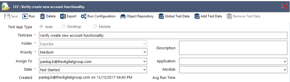

1] Local Test Data
Once users have created a test case, they can use the Parametrization feature to test different data sets, as shown in screenshot below. Global test data is not specific to any project and is available on the main dashboard. On the other hand, parameters specific to a test case (local data) are available on the test case window.

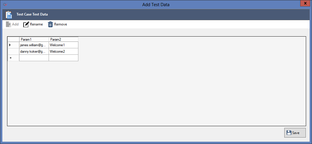

Once users have added the parameters, they can save it by clicking on “Save”, as shown below.

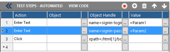

After adding test data, the script will look like the screenshot below.

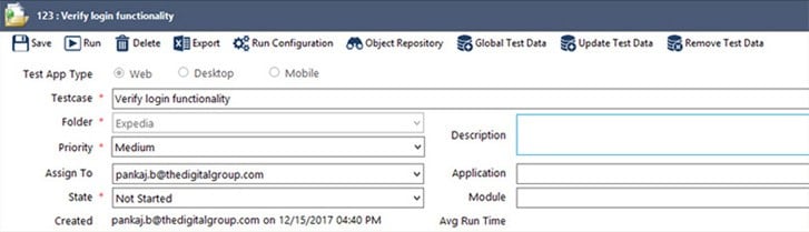

Updating Test Data
If users want to update the saved Test Data, they need to click on ‘Update Test Data’ as shown below. The window that opens, gives users the option to ‘Add’, ‘Remove’ or ‘Rename’ the parameters, as shown in the screenshot below.
Note: If you wish to test a Web application using only one data set, you can delete the extra parameters by clicking on “Remove Test Data”.

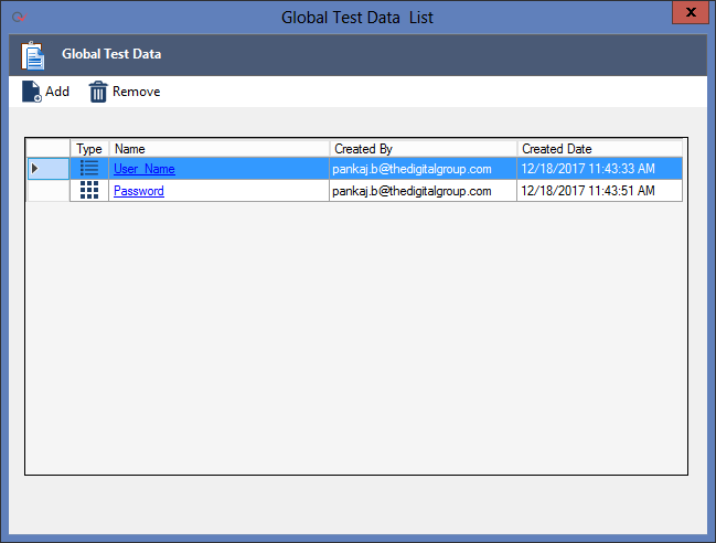

2] Global Test Data

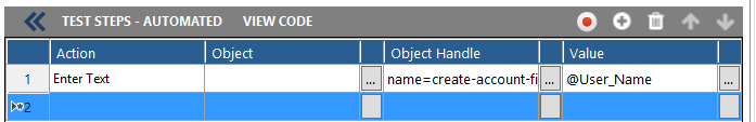

Global Test data is applicable for multiple test cases. It is data that has been provided globally in QARA. We can create Global Test Data using two data sources called Table and List. Values chosen from the Global Test Data are indicated by “@” in the Automated Test Steps panel.
Note: As shown above, the values taken from the global data list and local data have been denoted using the symbols “@” and “=” respectively.
