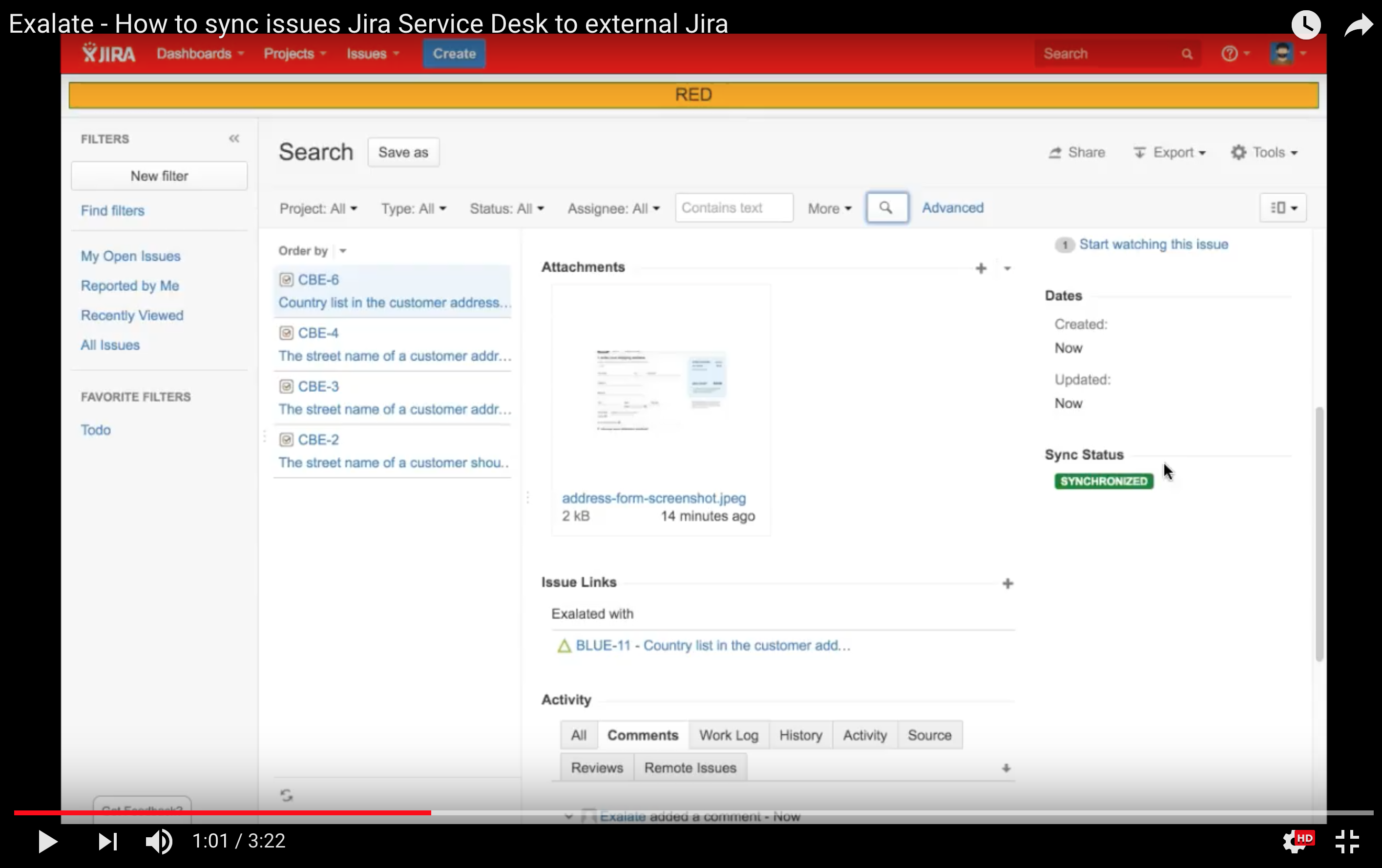

Some time ago we got a request from one of our prospects. They were looking to sync issues from an external facing JIRA service desk with an internal development JIRA.
The external JIRA is configured with a single service desk configuration - providing generic request types such as 'Raise a problem', 'Submit an idea' ... Some of these requests need to be escalated to the internal development JIRA and kept in sync such that the support engineer can keep in touch with the customer whenever development has a couple of questions or whenever a fix is made available.

When a support engineer escalates a customer request to development - the request should be copied over to the development JIRA (in the right project !) and all information must be kept in sync. Development needs to know which customer has raised the issue, it must be possible to request additional information (such as log files or screenshots), and support must work with the customer once that the issue is resolved.
How to sync multiple Jira instances: Configuring Connection

Enter Exalate - the flexible JIRA Synchronisation solution.
Check the getting started guide for more details to set up the synchronization between two JIRA instances. At a certain stage of the configuration, it is necessary to configure the synchronization such that the new issues get created in the appropriate development project.
