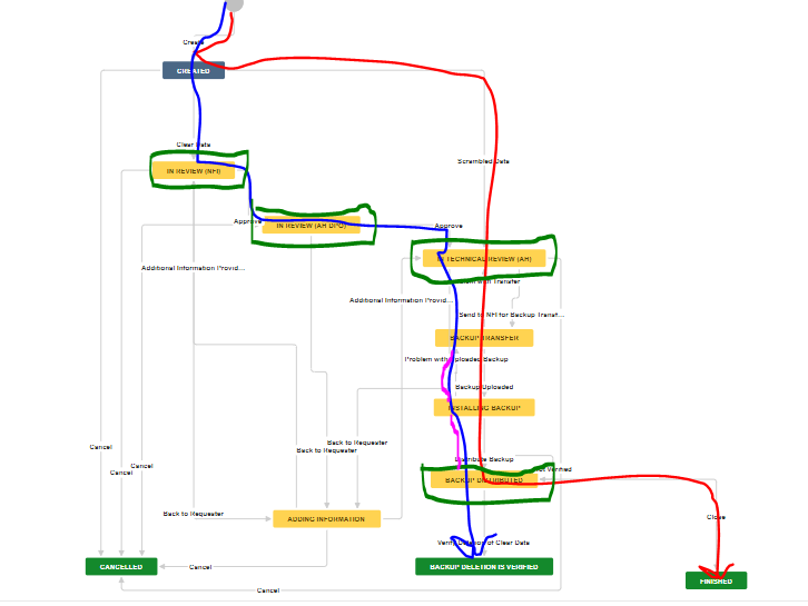

I created a workflow which is forking in the beginning and than coming together later
I did the forking with conditions.
Here is the workflow:
Red is one path, blue the other one. With the green Statuses there is an approval needed. With the pink transitions I have an issue.
If I walk the red path those transitions are working, If I walk the blue path they are not

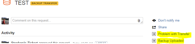

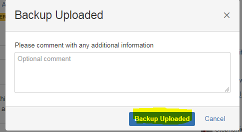

If I click in the Customer Portal on the Button "Backup Uploaded" nothing is happening. I need to cancel.
If I take the red path it is working (Customer User/Agent User).
But I can do the transition from JIRA while taking the blue path as an Agent.

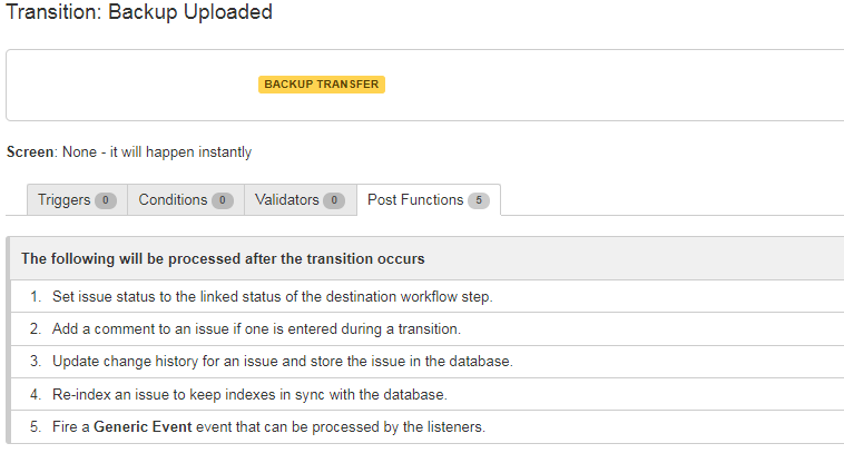

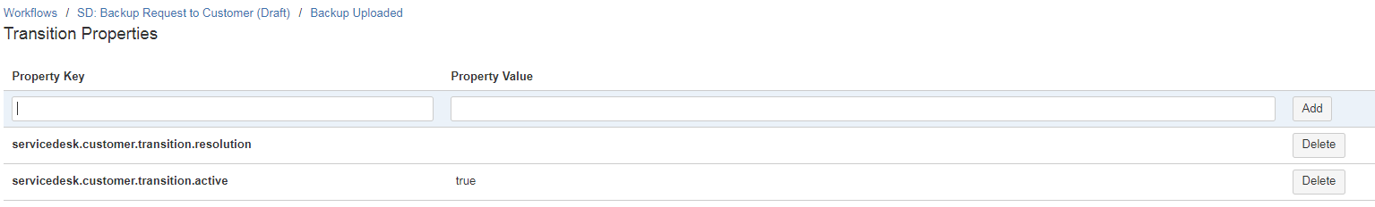

On the Status are no properties attached.
On the Transition are only the standard functions of JIRA attached:
