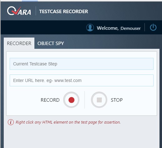

1. Select the Testcase Recorder feature. A representation of the screen is shown below.
2. Under the Recorder tab, enter the ‘Current Testcase Step’ and the URL.
3. Click on the Record radio button to start recording.
4. Click on the Stop radio button to stop the recording.
Once the recording is complete, the recorded test cases are automatically saved in the test cases folder of QARA Enterprise. Also, QARA Enterprise allows the automatic addition of object handles to the Shared Object Repository when recording test case activities.
