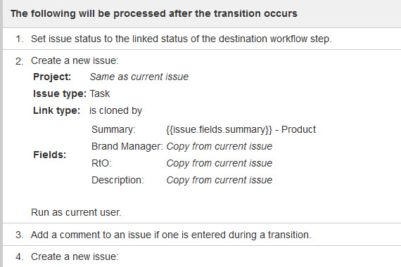

I have a Create Issue post-function on a status transition which is not 'firing' at all i.e. no issue is being created. My inclination is that it may be because of required fields however I cannot reconcile that.
The Create issue post-function looks like this (I am copying the three required fields from current issue - I would assume this is enough):

request: {
"body": "{\"fields\":{\"project\":{\"key\":\"TEST\"},\"issuetype\":{\"id\":\"3\"},\"summary\":\"fluff - Product\"}}",
"href": "https://xx.atlassian.net/rest/api/2/issue",
"method": "POST"
error: {
"codeString": "400",
"fields": "{\"authentication\":7,\"triggering\":3,\"queue\":3,\"execution\":1154}",
"message": "Unexpected response: 400",
"code": 400,
"name": "Error"
configuration: {
"conditionalExecution": false,
"fields": {
"summary": {
"action": "set",
"value": "{{issue.fields.summary}} - Product"
"project": "$sameAsCurrentIssue$",
"navigateToNewIssue": false,
"selectedLinkType": "inward:10001",
"issuetype": "3",
"runAsType": "currentUser"
If anyone has any idea what is causing this lack of creation it would be most helpful and much appreciated
